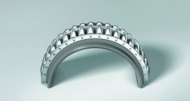

NSK manufactured special split spherical roller bearings for the steel mill
Meticulously planned removal and reassembly
As requested by the customer, NSK produced a special split bearing (image 2) as replacements for the standard spherical roller bearings used previously. Among the special features customized to the specific space constraints of the converter’s configuration, the new bearings offered an outer diameter of 1000 mm to permit simplified installation and disassembly without any requirement to remove the large tilting gear unit, thus saving time and cost for the customer.

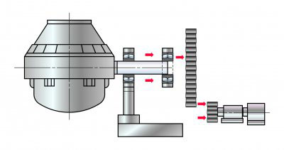

The use of split bearings greatly reduces replacement time in converters, shown here with drive unit
NSK planned the replacement procedure with care to ensure minimum converter downtime. The tilting drive unit (image 3) was lifted sufficiently for the spherical roller bearing to be cut and removed. Once this was complete, significant signs of wear could be seen on the rollers, raceways and cage.
It took NSK technicians just three days to install, test, measure the new bearings and deliver safety training with the support of the steel mill’s management team. Throughout the process, NSK’s strict quality controls were observed, both with respect to precision, as well as cleanliness of the production environment. – The immediate working zone and nearby areas were closed off using foil to protect the bearing installation from any contaminants that may emanate from other maintenance procedures taking place concurrently in the smelting shop.
As demonstrated by measurements before and after a converter test run, all parameters were within pre-specified deviation tolerances, including the bearing clearance. With the converter and smelting production duly back in operation as planned, the steel mill staff responsible for the project were extremely pleased with the co-operative effort.
