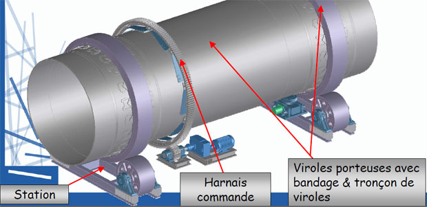

ALC Tournai – Range of Plain Bearings

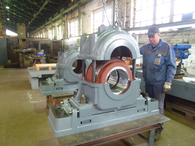

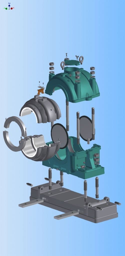

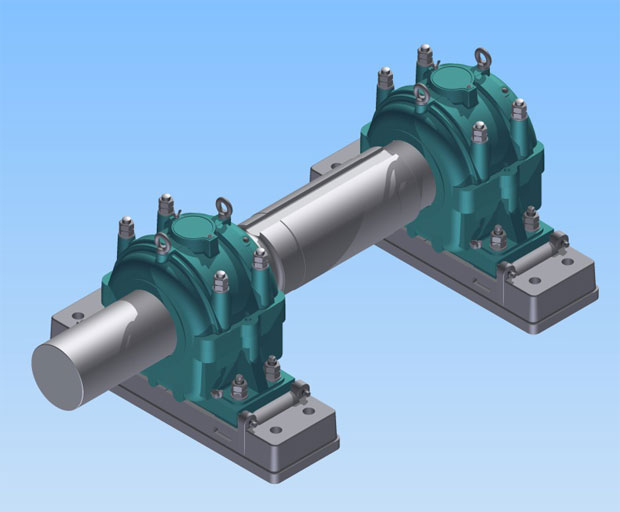

For more than 60 years, ALC Tournai has developed a range of plain bearings with standard diameters ranging from 200 mm to 400 mm. The bearings possess a bush mounted on a ball adapted to support the pinion shaft of the gear drive. For uses in rotating mills and kilns, ALC has the appropriate models. Bearings work in pair. Taking into account the size, load and rotation speed, they are designed to allow a perfect lubrication of the bearing and respond to the transmission shaft behaviors.
Advantages
ALC bearings have diameters ranging from 200 to 400 mm, and thus respond to the specific requirements of most of the transmission shafts of rotating machines.
ALC white metal bearings’ main benefits are:
- An easy and fast assembly
- An excellent tolerance to shaft behaviors: ALC ball bearings can adjust to the different shaft movements to reach optimum stress distribution in the bearing. The bearings are wear- and vibration-resistant. If the lubrication is correctly carried out, wear is close to zero, reaching a very long service life.
- Minimal space requirements
- Unrivaled service life
- Low maintenance
- Product manufactured with independent spare parts. The benefit is to have the possibility to replace one piece with another without replacing the whole product. Disassembly can be effected as quickly as assembly.

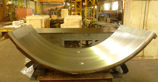

ALC Tournai – Babbitt Services

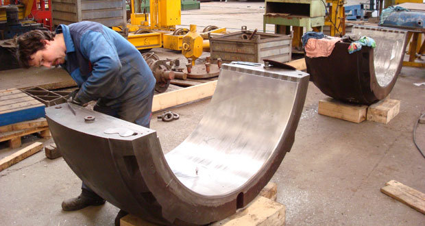

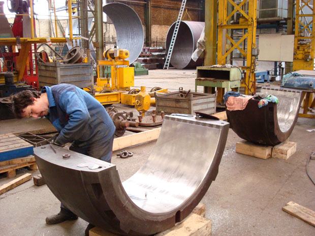

Taking advantage of its mastery of the cast Babbitt know-how, ALC Tournai proposes to assist its clients in the repair of any type of pieces –medium-sized to very large pieces– with an antifriction metal lining.
With the mastery of rod and static casting techniques, ALC Tournai offers the most economical repair or replacement solution.
- Exterior lining of compressor cross
- Bearings/Bushed/Complete blocks of rolling trains
- Crusher bushes
- Command bearings
- Drive bearings of high dimensions
- Hydrodynamic pads
- Electric motor bushes
