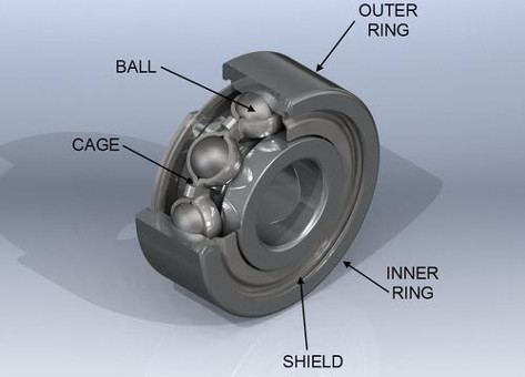

Bearing materials
All bearings should be manufactured using rings produced from high-purity material. For most medical applications, martensitic stainless steel, similar to AISI 440C, is recommended and often required due to regulatory requirements. This material, which can be specified differently depending on its manufacturer, provides for good corrosion resistance and has fine, evenly dispersed carbides, which result in lower noise and vibration levels than 440C. This type of stainless steel is very desirable, particularly in high-speed devices.
Nitrogen-enhanced martensitic stainless steel is also available, and while it is more expensive, it offers up to five times the corrosion resistance when compared to traditional 440C type materials. Other benefits of this material are very low noise levels, extended fatigue life due to its fine structure that contains smaller chromium nitrides (as opposed to chromium carbides), and a high resistance to corrosion resulting from exposure to blood.
In some cases, balls produced from ceramic materials, such as silicon nitride, can prove beneficial. Ceramic balls exhibit high hardness and are lightweight, highly polished, nonmagnetic, and resistant to attack from most liquids and chemicals. Ceramic balls greatly improve the high-speed capability of the bearing. Bearings made of steel rings and ceramic balls are commonly called hybrid bearings. While ceramic balls have an impressive list of beneficial characteristics for bearing applications, they are not a cure-all medicine. Due to the high hardness of the ball, contact stress is increased, so fatigue life is compromised. When the typical failure mode is characterized by fatigue, it’s usually best to stick with steel balls.
Retainers, or ball separators, are typically produced from a 300 series stainless steel. In high-speed applications, it is often necessary to use a plastic or phenolic resin snap-in or crown style retainer. For very high speeds, an angular contact bearing with a full-machined retainer is recommended. These types of retainers provide increased stability at higher speeds.
Phenolic resin cages have a porous structure and can be impregnated with oil for additional lubricity. Some of the plastic materials, such as polyamide-imides, contain additives such as graphite and Teflon for additional lubricity in emergency running conditions. A wide array of lightweight plastic materials are available that can handle temperatures up to 500F and are autoclavable.
An autoclave is a device used to sterilize surgical tools, dental drills, or other devices by subjecting them to high-pressure saturated steam for around 20 to 30 minutes depending on the size of the load. This is a common practice that can hurt the bearing materials and lubrication.

Running at high speeds also presents challenges with instrument noise levels and heat generation. High audible noise during a dental procedure is a problem for both the dentist and the patient. When bearings are assembled, it is necessary to have a certain amount of internal clearance, or radial play, built in. This allows for one bearing race to move both radially and axially relative to the other.
Application of a preload across a pair of bearings is recommended. Preload can be defined as the application of an axial load across a pair of bearings to force the rolling elements to assume a contact angle for the purpose of removing the internal clearance. The result is constant ball-to-race contact. This reduces ball skidding, vibration, and noise. However, disadvantages of preload include torque, heat, and reduction in fatigue life. Preload determination is a balancing act where the goal is to apply the least amount of axial preload force possible while meeting the performance requirements of the instrument.
During surgery, the bearings in tools are regularly exposed to harsh conditions and liquids, including blood and saline, as well as particulate debris. When space permits, shielded bearings should always be used. The speed of these tools is generally too high for seals, but when conditions permit, seals should be used. Seals are the best option for keeping foreign debris out of the interior of the bearing and keeping lubricant in.
