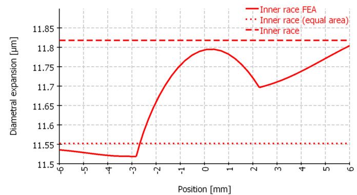

Figure 1 shows the diametral expansion of a 71910C bearing inner ring considering an interference of Iw = 13 mm and speed zero. The solid line shows the expansion of the outer contour of the ring according to the FEA calculation, the dotted line shows the expansion using thick ring theory and a diameter for the equivalent cross section and the dashed line shows the expansion for thick ring theory and the outside diameter Dpw-Dw.
It can be seen that the expansion in the middle of the bearing is very close to the value not considering the shoulders and the value at the left shoulder is closer to the value for the equivalent cross section. It should be noted, that the difference is about 0.3 mm, so the effect of unreliable smoothing of the surface roughness is larger than this variation.

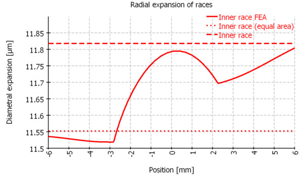

Figure 2 shows the result of the same example, but with rotation speed of 30000 rpm. Here the expansion of the equal cross section case is larger than in the case without considering the shoulders. The reason is the larger mass and the larger effective diameter for the centrifugal forces.

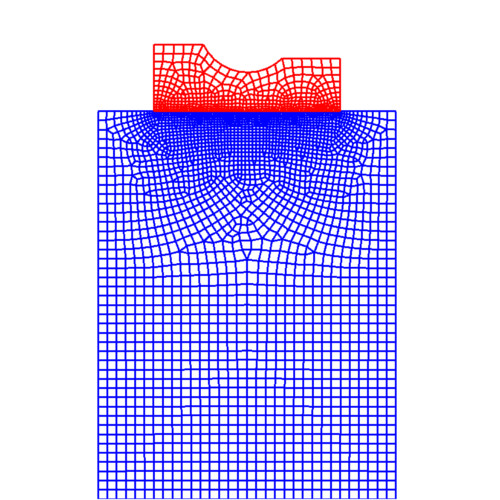

Figure 3 shows the mesh used in these two calculations. The width of the shaft is a little larger than the bearing width as it is in real applications. Quadratic elements are used.

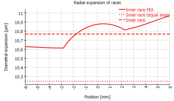

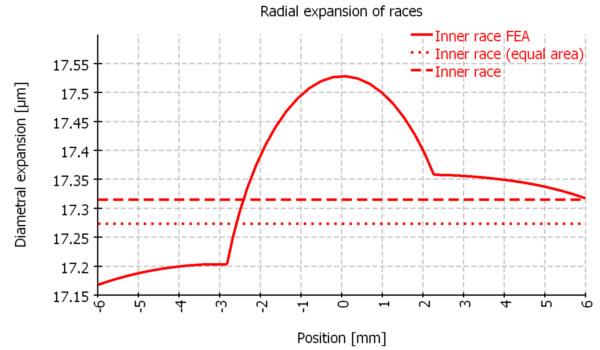

For the same example a hollow shaft with inner diameter dsi = 30mm instead of a solid shaft is considered in figures 4 and 5. Figure 4 shows a larger difference for the two cases based on thick ring theory. The case with equivalent cross section is too stiff here. Including centrifugal forces the differences are small again.
These examples show that the consideration shoulders for the calculation of fits is not required in many cases and a calculation using a simplified approach with Dpw±Dw can lead to more accurate results for low speed cases. Still mostly the differences are much smaller than the effect of surface roughness would be.
