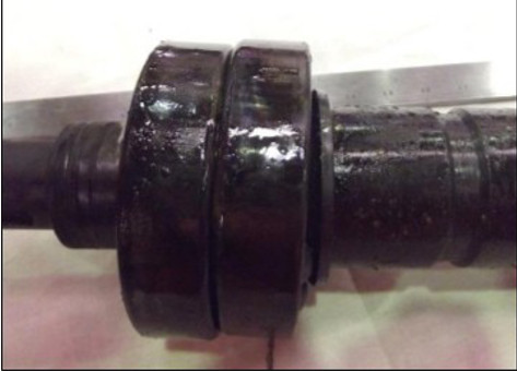

As an example the above photo shows 2 single row angular contact ball bearing mounted in pair in a centrifugal pump. Wrong bearings as they were not adjusted for mounting in pair, thus the lack of 2 letters in the bearing designation caused an extremely expensive fire in a refinery, fortunately without any personal injuries in this case.
