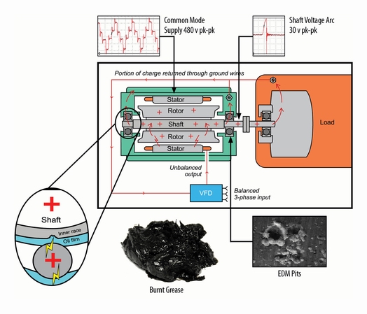

By now it is widely understood that induced shaft voltages discharge through the bearings of many VFD-controlled, alternating-current (AC) motors (See Figure 1). The high switching frequencies of today’s VFDs produce parasitic capacitance between a motor’s stator and rotor. Once the resulting shaft voltages reach a level sufficient to overcome the dielectric properties of the bearing grease, they discharge along the path of least resistance — typically through the bearings (See Figure 2). During virtually every VFD switching cycle, induced shaft voltage discharges from the motor shaft to the frame via the bearings, leaving a tiny pit (usually 5-10 microns in diameter) in the bearing race.
Figure 1
The bearings of VFD-driven motors can be damaged by currents from three sources: capacitive induced shaft voltage (A), high-frequency flux produced by common-mode voltage (B), and sinusoidal voltage (C).

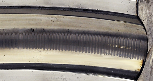

These discharges are so frequent (millions per hour) that — through the process of electrical discharge machining — they create millions of fusion craters, or pits. Before long, the entire bearing race can become marked with countless pits known as frosting. A phenomenon known as fluting, which shapes the frosting into washboard-like ridges across the bearing race, may occur as well (See Figure 3). Fluting can cause noise, vibration, increased friction, and catastrophic bearing failure.
Figure 3
In a process called fluting, pits form washboard-like ridges on a bearing race wall — ridges that cause still more noise and vibration and accelerate bearing failure.

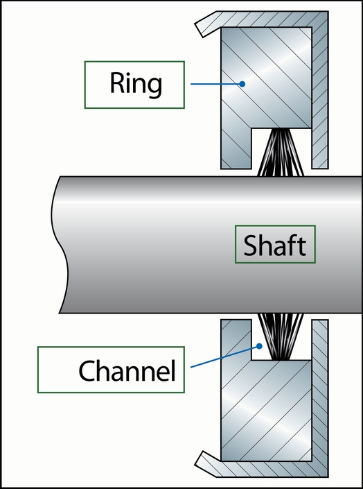

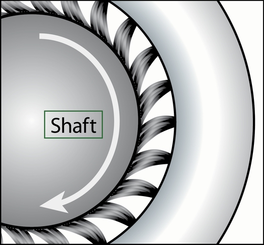

If inspection of the old bearing indicates electrical damage, the best way to protect replacement bearings is to install a shaft grounding ring that has a full 360 degrees of circumferential conductive microfibers touching the motor shaft. Such a ring will conduct harmful shaft voltages away from the bearings and safely to ground. With a ring installed, voltage will travel from the motor shaft, through the ring’s conductive microfibers, to its housing, then through the motor’s housing to ground (See Figures 4 and 5).
Figure 4
The best grounding rings are lined with flexible, conductive microfibers that completely surround the motor shaft.
Figure 5
A channel locks the ring’s conductive microfibers in place around the motor shaft and helps protect them from excessive dirt, oil, and other contaminants.

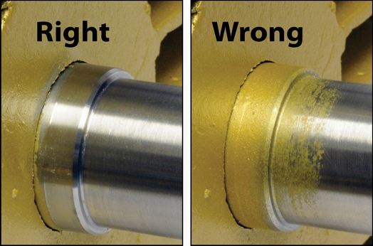

All paths must be conductive, so paint on the motor’s faceplate must be removed. Likewise, the motor’s shaft must be clean down to bare metal, free of any coatings (See Figure 6). Depending on its condition, the shaft may require scrubbing with an emery cloth or a similar material. Even when the shaft appears clean, wiping it with a nonpetroleum-based solvent will remove unseen residues. After cleaning, the conductivity of the shaft should be checked with an ohm meter. If the reading at the portion of the shaft that will contact the ring’s microfibers is higher than two ohms, the shaft should be cleaned again.
Figure 6
Prior to installation of a grounding ring, the motor shaft must be cleaned down to bare metal, free of any paint or other nonconductive material.

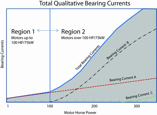

For horizontally or vertically mounted motors with horsepower of 100 (75 kW) or less and single-row radial ball bearings on both ends, a shaft grounding ring can be installed on either end. For horizontally mounted motors with horsepower greater than 100 and single-row radial ball bearings on both ends, the bearing housing at the nondrive end must be electrically isolated to disrupt circulating currents. Options for achieving such isolation include insulated sleeves, nonconductive coatings, ceramic bearings, or hybrid bearings. The grounding ring should be installed at the drive end.
For any motor in which the bearings at both ends are already insulated, the drive end is preferred for the installation of a grounding ring, to protect bearings in attached equipment such as a gearbox, pump, fan, or encoder.
For any motor with cylindrical roller, Babbitt, or sleeve bearings, the end with such bearings should be electrically isolated, and the grounding ring should be installed at the opposite end.

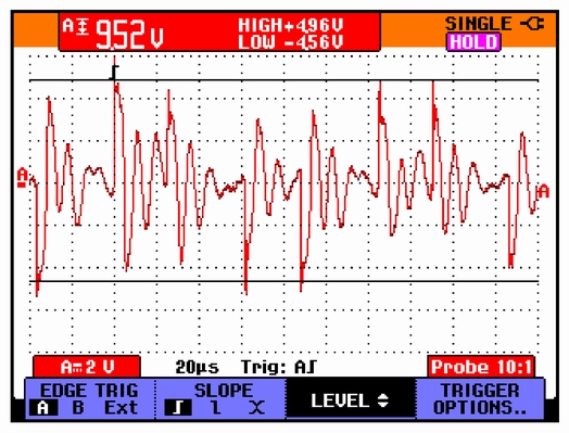

Measuring shaft voltage on a VFD-driven motor provides valuable information for determining whether or not there is a risk of electrical bearing damage. The best time to take such measurements is during the start-up of a new or recently repaired motor. Every motor has its own unique parameters. Combined with vibration analysis, thermography, or other diagnostic services, results (including saved oscilloscope-screen images) can be presented in a report to the customer. Results should also be used in developing preventive and predictive maintenance programs.

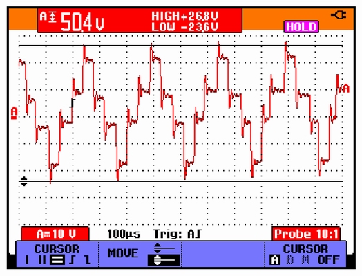

Shaft voltages are easily measured (using appropriate safety procedures) by touching an oscilloscope probe to the shaft while the motor is running. The best probe will have a tip of high-density conductive microfibers to ensure continuous contact with the rotating shaft. A portable oscilloscope with a bandwidth of at least 100 MHz should deliver accurate waveform measurements (See Figures 7 through 10). Probe/oscilloscope kits are available.
Figure 7
The six-step (or square) oscilloscope waveform shown here is typical of motors exhibiting maximum peak-to-peak shaft voltages, but no discharges through the bearings.

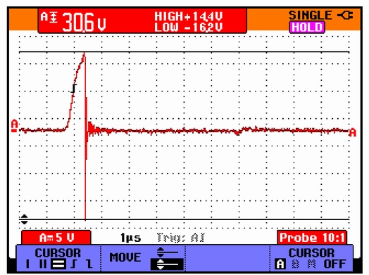

Figure 8
The above waveform shows the rapid voltage discharge through the motor’s bearings that occurs when shaft voltages reach a level where they overcome the dielectric properties of bearing grease.
Figure 9
The continuous discharge pattern indicated by the relatively low-voltage waveform on this oscilloscope screen is the result of the bearing lubrication becoming conductive.

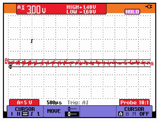

Figure 10
With an effective, properly installed grounding ring to protect its bearings, a motor produces an oscilloscope waveform like this one, with peak-to-peak discharges of only two or three volts.
Just as shaft voltage measurements can show that a motor’s bearings are in danger of electrical damage, they can confirm that a shaft grounding ring is working. If a proven ring has been properly installed, typical discharge voltage peaks should be less than 10 volts, depending on the motor.
