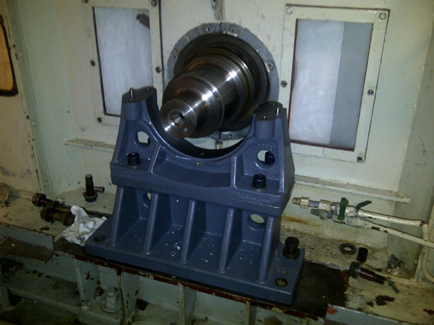

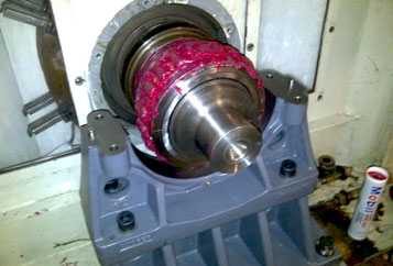

These problems called for a solution that did not require alteration of the generator itself: The new bearing would have to be a direct, ‘drop-in’ replacement. Since the icebreakers have heavy work schedules, downtime must be kept to a minimum. The Cooper solution was to provide a high-quality split cylindrical roller bearing as a direct replacement for the existing sleeve bearings. The split bearing has a special cartridge that holds the shaft-end cover and is mounted on a standard pedestal. A support plinth and elevating pedestal were built to customer specifications to provide dimensionally identical support for the shaft.

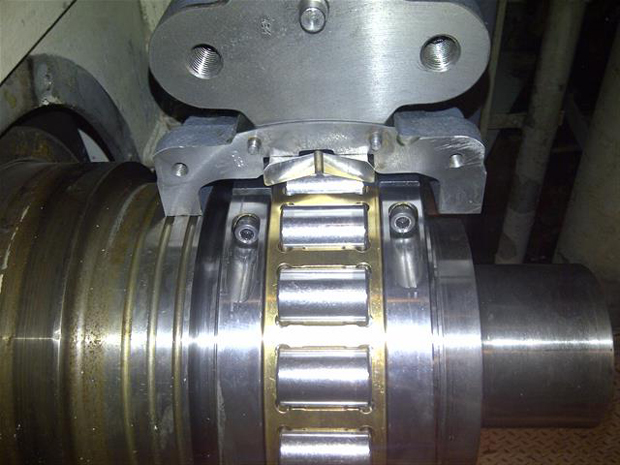

Cooper bearing installed on the shaft, with support plinth and standard pedestal base
Fully installed split bearing unit
The new solution allowed rapid replacement without modification of the generator. The roller bearings are fully split up to the shaft, and the labyrinth seal is also of a split design. They have clear advantages over the previous sleeve bearings: Their design allows easy-access inspection and maintenance, since no other components need to be removed. This significantly cuts standstill times and maintenance effort. The bearings have a long service life and do not need oil lubrication, eliminating the need for pumps and filters and the risk of oil leaks. The bearings run cooler and consume less power. There is no longer a risk of damage to the shaft from bearing failure.
