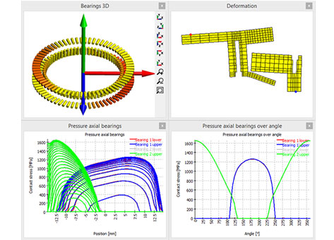

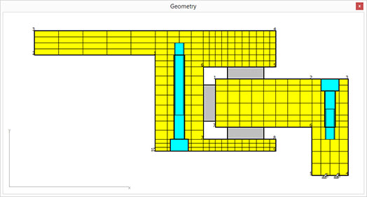

MESYS provides a FEA based calculation program which allows the user to model the bearing geometry as axial symmetric parts connected by roller bearings. The parts are defined as a polygon, loading can be defined on surfaces or points. Multiple bearings rows can be added, supported types are: axial roller bearing, radial roller bearing, cross roller bearings and angular roller bearings. Bolted joints can be defined as they affect bearing pretension.

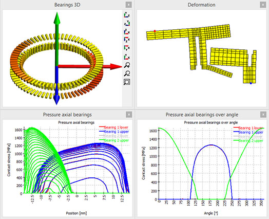

The deformations of the parts are calculated by FEA, the contact between rollers and races is calculated analytically and is based on the contact stiffness in ISO/TS 16281. By using the load distribution on the rollers, the contact stress and bearing life according ISO/TS 16281 are calculated.
The stiffness is determined by selecting two points from the axial section of the geometry and by applying the load in different steps. The difficulty regarding the stiffness is the selection of boundary conditions which have a large impact on the resulting stiffness.
The following results are available:
- Force and moment on each bearing row
- Nominal and modified reference life according to ISO/TS 16281
- Max contact stress for each bearing row
- Diagrams for contact stress on each bearing row in 2D and 3D
- Deformation as 2D diagram or 3D view
- Stiffness derived from two selected points and load steps
- The maximum and minimum load on the bolts
