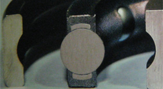

Cobra Solid Lubricant is a graphite-based solid lubricant that is injected into a clean bearing and then thermally cured to harden within nearly 100% of the space between the inner and outer races. It is specifically designed for ball and roller bearings and completely encapsulates the balls or rollers along with the cage. When the bearing rotates, the graphite deposits a thin film of graphite on every contact surface, providing a low coefficient of friction over the races. This is particularly effective in high temperature applications, since no lubrication will purge from the bearing, which ensures a longer and more effective bearing life.
