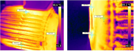

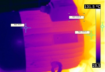

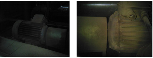

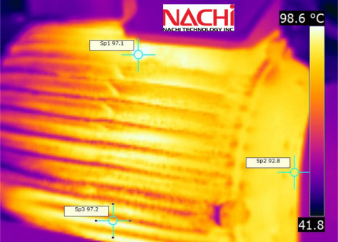

The hot oil pump motor which was used for the press machine reached operational temperatures between 90-100 ° C. The vacuum pump motor stopped working continuously and reached temperatures between 100-110 ° C.
In addition the high temperature bearings failed after six months because of the complications connected to high operation temperature.
tested hot oil pump motor
tested vacuum pump motor

After analyzing the situation our reliability staff concluded that the air circulation around the ‘hot spots’ was not sufficient enough to cool down the operational temperature of the pump motors.
thermal camera screenshots of the tested hot oil pump motor
thermal camera screenshots of the tested vacuum pump motor
