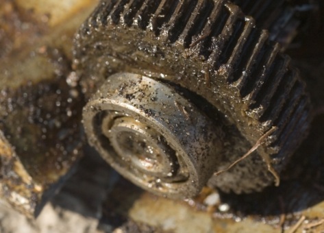

Corrosion
Causes: Moisture, acid action, poor or broken down greases, poor wrappings, and condensation resulting from excessive temperature reversals. Corrosion is abrasive to the finely finished surfaces of ball and roller bearings.
What to look for: Red/brown stains or deposits on rolling elements, raceways or cages. Increased vibration followed by wear, increase in radial clearance or loss of preload.
How to fix it: Divert corrosive fluids away from bearing areas. Use integrally sealed bearings, and consider external seals for particularly hostile environments. Also, use of the proper bearing material (stainless steel) can help if you cannot avoid a caustic environment.
