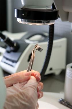

The problems with handling bearings begin the moment they are removed from their protective packages. Because of this, it is best not to remove them until they are ready for use, and then only after the work area has been effectively cleaned and prepared. Once unpacked, the bearings should only be handled with clean, dry, talc-free gloves. Here, care should be exercised as material incompatibility between the gloves and any cleaning solvents could result in contaminant films being transferred to the bearings during subsequent handling. Where the bearings are instrument types, even handling with gloves should be avoided in favour of surgical tweezers.
