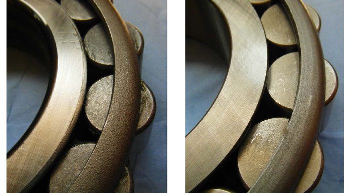

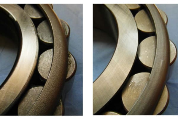

Faced with this baffling failure, emphasis shifted to the quality of the tapered roller bearings, type HR 30322J. Detailed images of the bearings were sent to NSK and all became clear: the bearings were counterfeit.
The counterfeiters had gone to great lengths with the appearance of the bearings; even the NSK logo looked deceptively authentic. In fact, the only way to distinguish between the original and counterfeit bearings was to scrutinise the quality of the individual bearing components.
