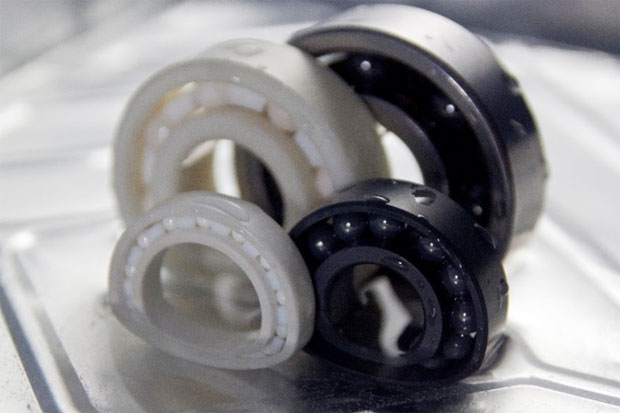

Zirconia (ZrO2) was developed in the 1960s and ‘70s to produce a thermal barrier on the external tiles of a space shuttle in order to allow the shuttle to re-enter the Earth’s atmosphere without disintegrating. Since then, Zirconia has been the material of choice for high temperature and highly corrosive applications. The density and thermal expansion of Zirconia is more similar to steel than that of any other ceramic material; therefore, it does not have the same weight saving and thermal shock resistance enjoyed by other ceramic materials. However, compared with Silicon Nitride and Silicon Carbide, Zirconia has a high fracture toughness. Zirconia is white in colour.
Picture 2: Examples of Zirconia, left, and Silicon Nitride Bearings, right

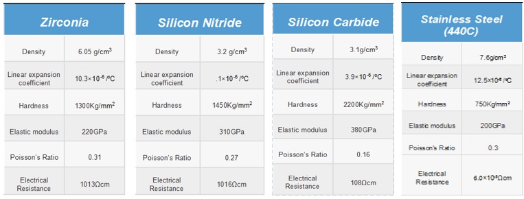

The material properties of these ceramic materials are listed in the tables below along with 440C Stainless Steel for comparison purposes.
Table 2: Material properties of Zirconia, Silicon Nitride, Silicon Carbide and 440C Stainless Steel
