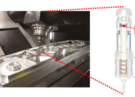

Machine tool manufacturers and spindle manufacturers specializing in main shafts have been developing a diverse range of products designed to instantly meet the needs of users in recent years. Machine tool spindles are designed taking into account the characteristic values of bearings that are used, and after receiving various information such as usage conditions proposed by customers, bearing manufacturers must calculate the characteristic values of multiple potential designs quickly and in detail before submitting materials to customers.
