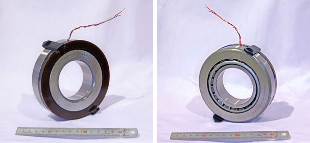

(Bearing outer diameter φ130 mm, bearing inner diameter φ65 mm). Support available for all sizes upon consultation

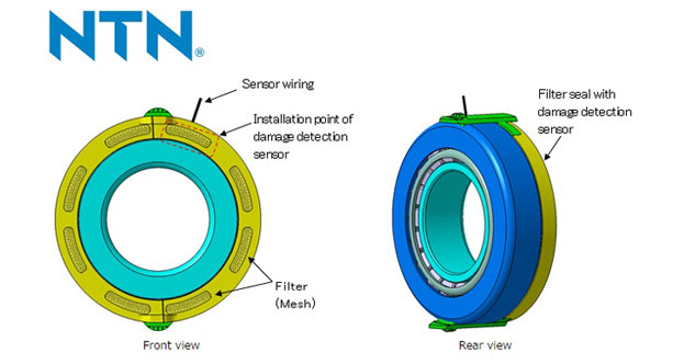

| Front view | Rear view |

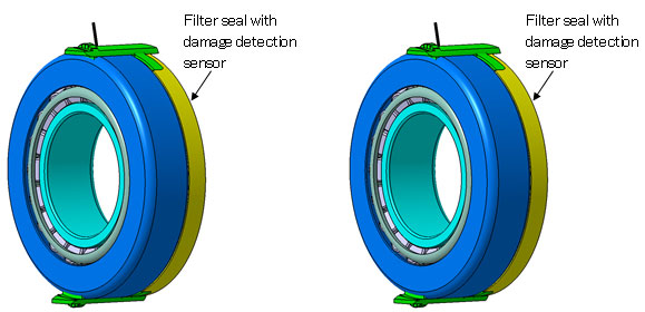

NTN has developed a product that prevents flaking fragments from being discharged outside of the bearing by installing a filter seal on the outer ring, which is a stationary ring on the tapered roller bearings, and by optimizing the clearance between the inner ring and filter seal. Also, by optimizing the sensitivity of the damage detection sensor attached to the filter seal, NTN has achieved a technology that can detect whether flaking only has occurred at an early stage without detecting fine iron powder or suspended metal particles. In addition, the filter seal has a special construction that also allows it to be retrofitted to existing tapered roller bearings.

| (1) Can detect flaking on tapered roller bearings at an early stage | Detects flaking using a damage detection sensor |
| (2) Reduces the possibility of secondary damage occurring due to flaking on bearings | Controls the dispersion of flaking fragments using a filter seal and prevents secondary damage to peripheral components |
| (3) Can install on existing bearings | Can be installed without any dimension changes onto existing bearings because of its parted construction |
