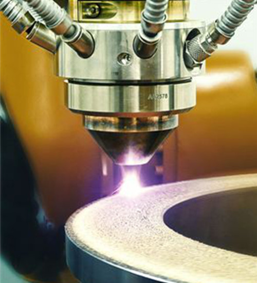

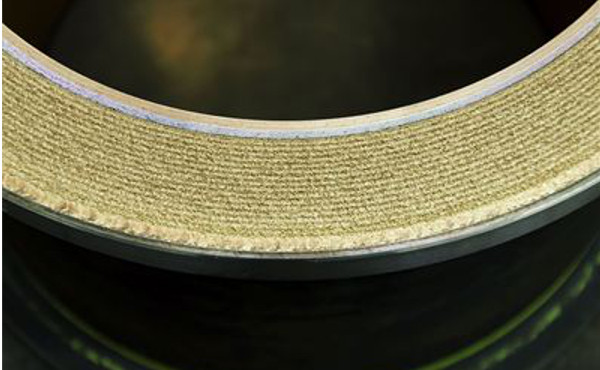

A revolution in the production of sliding bearings: it’s only necessary to apply a layer of metal a few millimeters thick using the powder nozzle to reliably, cost-effectively, and easily protect the large shaft bearings used in ships from wear and tear. O.R. Lasertechnologie GmbH develops and builds robot-assisted laser systems for direct metal deposition (DMD) that take the production and repair of sliding bearings to an innovative new level.

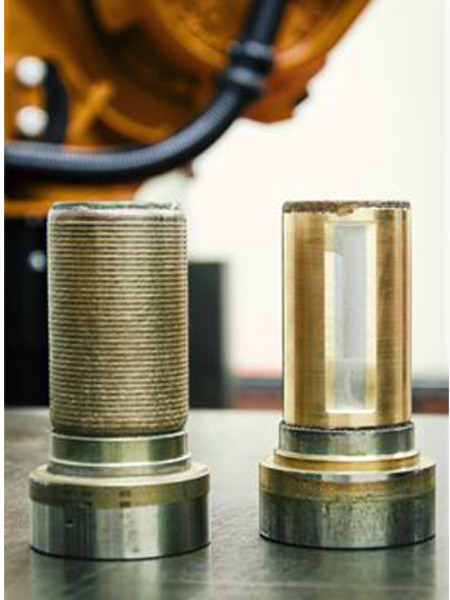

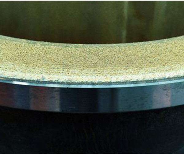

Today, latest-generation lasers can be used with a powder nozzle for direct metal deposition, yielding considerable benefits: the metal alloy is fed in the form of a dry powder via the nozzle coaxially to the laser and melted onto the inside of the concave steel bearing shells. The laser permits accurate partial attachment of the alloy. It is only necessary to apply the expensive alloy to about 20% of the surface using this technique, compared to 100% with the traditional casting method. Use of a laser also saves time and energy, since only a small amount of metal needs to be melted in each case.
The ability to quickly change the alloy and apply coatings of nearly any kind of metal opens up incredible prospects for developing new products. AM enables completely new production processes that are able to flexibly accommodate customer wishes in a minimum of time.
Recently, the Berlin-based company of ADMOS Gleitlager began using a laser system from OR LASER. In addition to having more than 100 years of experience producing cast compound hydrodynamic sliding bearings, it is constantly engaged in improving its products and methods.
ADMOS is now taking a new approach to making sliding bearings: with a robot-assisted laser system, a six-kilowatt fiber laser, and two high-power coating heads in the form of powder nozzles. Something that was impossible with the conventional casting process is now becoming reality: namely the use of copper-based materials such as CuSn and CuPb. One of the many advantages of the new approach is that different materials now bind more firmly to one another. All in all, the new method makes it possible to completely eliminate several steps while minimizing the required finishing work afterward.
Jörg Hosemann, the CEO of ADMOS Gleitlager, is thrilled: “The new laser system opens up a whole new world of possibilities for us: faster production and delivery at short notice, as well as enormous potential for slashing costs. I expect the investment in new laser equipment to pay for itself in no time.”
