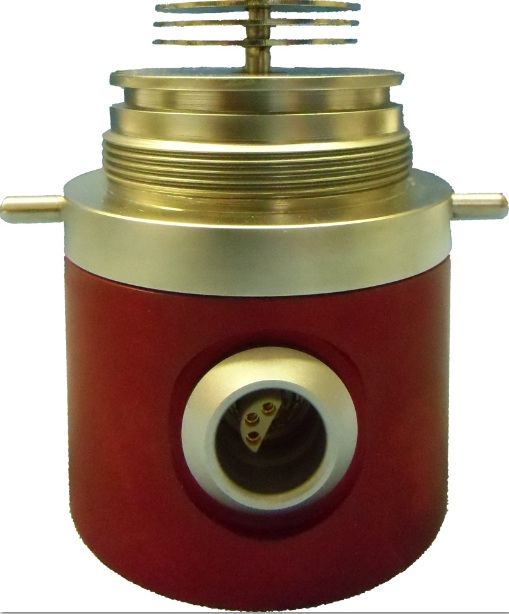

With the OilQSens® unit, components of the complex impedances X of oils, in particular the specific electrical conductivity k and the relative permittivity er as well as the oil temperature T are measured [1-3]. The values k and er are determined independently of each other. Fig. 1 shows the sensor with its triple plate design.
OilQSens01w
Fig. 1: Sensor with triple plate design.

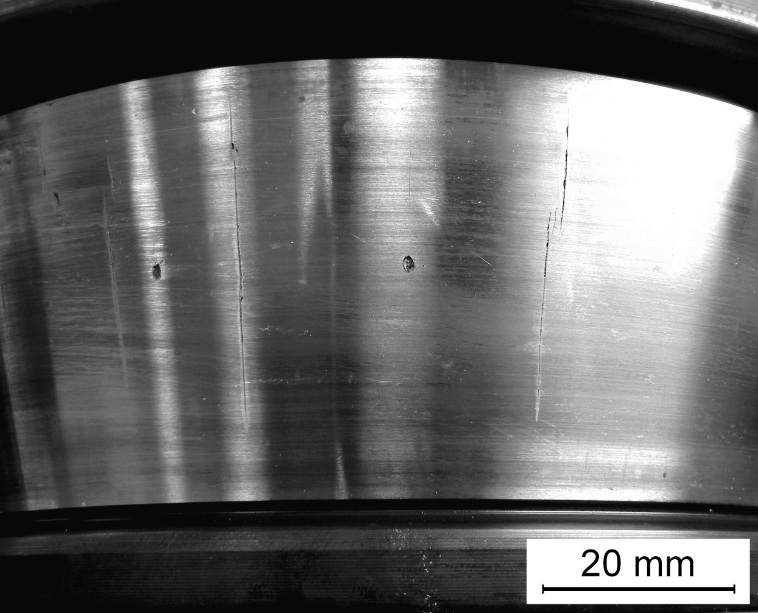

Bearings in industrial, e.g. wind turbine, gearboxes quite often suffer from a significantly shorter life than calculated by so-called white etching cracks [4]. These early failures are characterized by mostly axial raceway cracks, revealing vertical semi to fully circular cleavage-like lenticular brittle spontaneous incipient cracks in preparatively opened original fracture faces. Occasionally, pock-like spallings are associated with the surface cracks, as shown exemplarily in Fig. 2 [5]. The developing deep crack systems are open to the raceway, from which oil penetrates and promotes further corrosion fatigue crack growth as well as local secondary microstructural changes in the form of crack path decorating white etching constituents. It is evident from fractography and X-ray diffraction (XRD) residual stress analyses that the cleavage-like incipient cracks are caused by frictional tangential tensile stresses, which occur in subregions of the contact area in vibrationally induced mixed friction operating conditions.
OilQSens02w
Fig. 2: Inner ring raceway with typical axial cracks and few associated pock-like spallings.

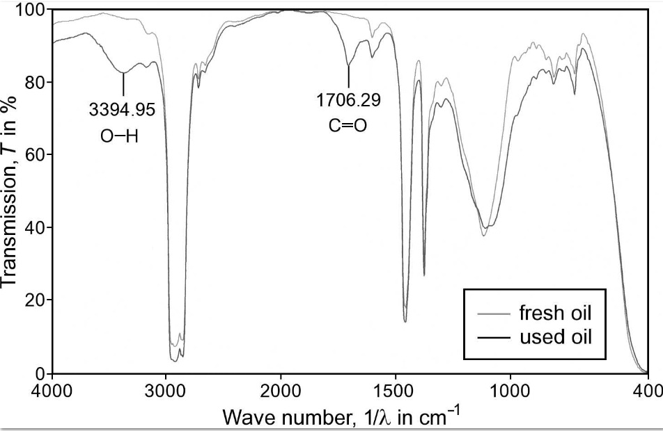

XRD based material response analysis of run rolling bearings, suffering from white etching cracks on still largely undamaged raceways, reveal the causative vibration loading. It is further reported that lubricant aging occurs under the influence of vibrations. An example of an infrared spectrum of used oil from rig test run of a roller bearing is provided in Fig. 3 [6]. The found O?H and C=O oxidation bands indicate operational acidification of the oil, also reflected in the dissolution of MnS inclusion lines on the raceway, as a result of polycondensation reactions towards resinification and beginning lacquer formation. It is this aging of the lubricating oil and its additives that can be detected in an early stage by the OilQSens® sensor.
OilQSens03w
Fig. 3: Oxidation peaks in the infrared spectrum of a used oil run under vibration loading in a rolling bearing test rig.

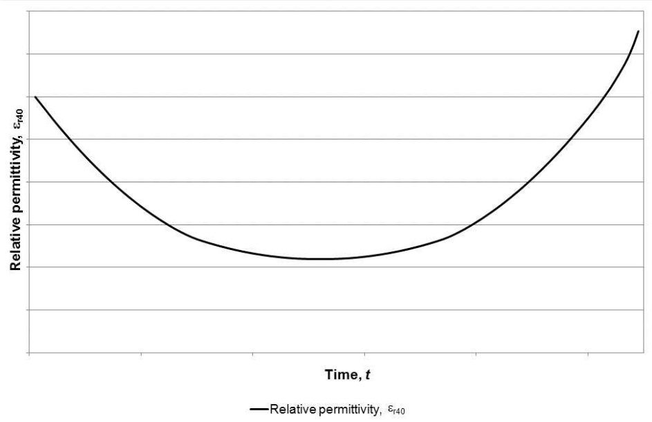

Fig. 4 schematically shows the temperature compensated time curve of the permittivity of additivated oil continuously contaminated by the addition of wear debris, water or oil acids from chemical aging. Once the additives are consumed, the vanishing shielding effect results in a characteristic re-increase.
OilQSens04w
Fig. 4: Temperature compensated permittivity.

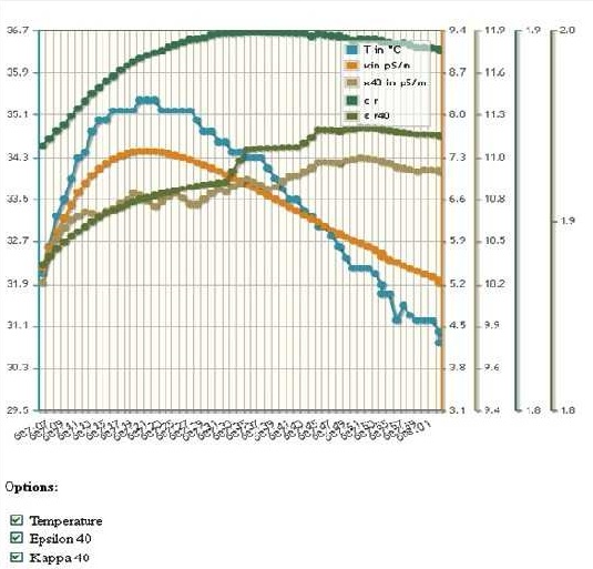

In a web-based decentralized online oil condition monitoring system, the sensor signals are preferably transferred through the Internet to a database server and recorded on an HTML page as user interface [8]. Fig. 5 shows the displayed measured data.
OilQSens05w
Fig. 5: The displayed measured data.

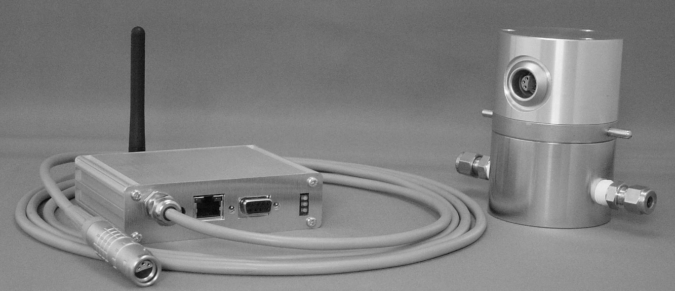

Following authentication, a simple web browser permits access via the wired or wireless LAN. In case of alarm signals, an immediate automated generation of warning messages, for instance by e-mail or SMS, is possible from any computer with Internet connection. Fig. 6 shows the OilQSens® sensor system with communication module [9].
OilQSens06w
Fig. 6: OilQSens® sensor system with communication module.
