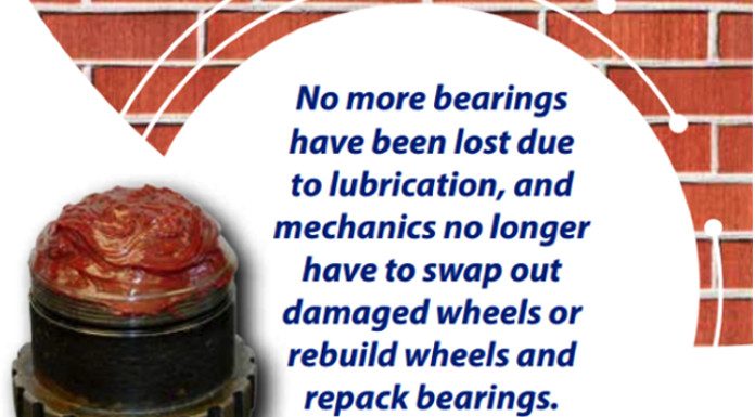

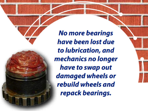

The bearings in the kiln cars failed because the “high temperature” commercial grease being used broke down and hardened in the bearings under the high-temperature conditions. The kiln reaches temperatures over 2,000°F (1,093°C), while the area under the kiln car – where the bearings are located – reaches up to 500°F (260°C). This caused the need for frequent lubrication, which included the tasks of hammering out hardened zerk fittings and chiseling old grease out of the bearings. To relube all of the cars, it took the lube technician 10 hours per day for eight days each month. At $16 per hour, the labor dedicated to re-lubrication was costing approximately $1,280 per month or $15,360 per year.
Even with the frequent relubrication, they were experiencing an average of two kiln car bearing failures per month, causing even more downtime. An average of 80 hours per year were spent by mechanics and lube technicians rebuilding or replacing damaged bearings and wheels.

Grady and Alan agreed to give Almasol 1250 a trial to see if it would hold up in the extremely high temperatures. The goal was to extend the lube interval from one month to two months. Every two weeks during the trial, the test cars rotated through the plant and the bearings were checked to see if the grease was still pliable and buttery. After two months of checking, Almasol 1250 had proven itself. The trial was a success.
Safely extending the lube interval from one month to two months using Almasol 1250 has cut lube costs in half and saved Boral $7,680 per year in labor. The kiln cars roll easily through the kiln, and lube techs no longer have to knock out and replace clogged zerk fittings, or chisel old grease out of bearings. No more bearings have been lost due to lubrication, and mechanics no longer have to swap out damaged wheels or rebuild wheels and repack bearings.
