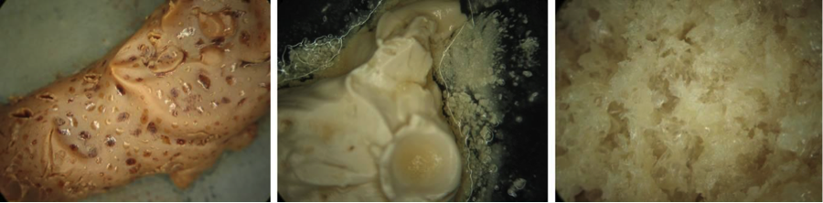

n GRW’s laboratory testing of 30 lubricants, each was subjected to 1,000 sterilization cycles with superheated steam. Initial testing eliminated 11 of the lubricants due to changes that limit functional behavior, such as water retention in the grease samples and thermal expansion during autoclaving.
The remaining 19 lubricants were subjected to analytical and visual testing criteria including weight and optical changes, scanning electron micrographic inspections and infrared spectra. Five of these lubricants were found to be particularly capable of withstanding repeated sterilization. Finally, GRW concluded that the best performing lubricants for medical and dental hand pieces were those consisting of polyurea-thickened greases using a base of mineral oil or PAO (polyalphaolefin).

Foaming, Water Retention, Base Oil Separation: Visual observations of the lubricants tested for optimum performance by GRW.

Taking into account all known criteria, GRW’s testing revealed that the best overall results were achieved using greases with a base of mineral oil or PAO. Notably, Greases thickened with special lithium or sodium soap additives are unsuitable for autoclaving. Superheated steam readily permeates these altered greases and has a negative effect on its adhesive properties, thereby limiting adhesion to the functional surfaces of the ball bearing.
