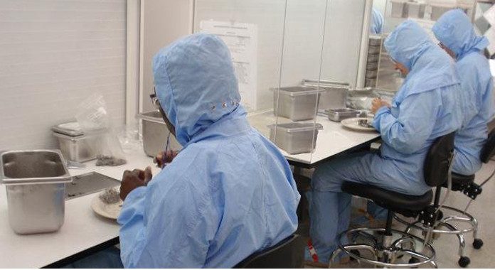

- Bearings should be handled in a dust free environment that is clean, dry and free of static.
- Clean, lint-free garments should be worn by anyone that enters the work area.
- Fluids, solvents, and other materials that are not part of the assembly process should be kept away from the assembly area to prevent contaminating the bearings.
- Machining, filing, soldering, grinding, etc should be kept away from the assembly area to prevent contaminating the bearings.
- All tooling and instruments should be non-magnetic. It is important to keep tooling and instruments clean and properly maintained to avoid burrs or other potential contaminants.
- Bearings should be handled with specially designed hand held instruments, such as plastic tweezers or tweezers with special work tips.
- In situations where the bearings must be handled by hand, it is important that clean, dry, unused, and lint free gloves and finger cots should be utilized. Never touch the bearings with bare hands or fingers.
