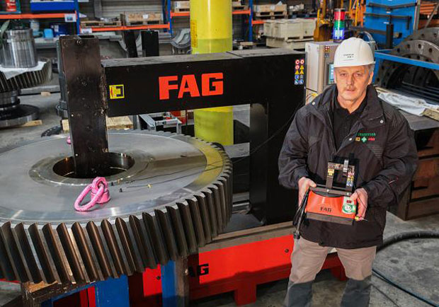

Schaeffler has supplied a special purpose induction heating device for large workpieces to TAKRAF GmbH, a manufacturer of bucket wheel excavators, stackers, crushers and conveyors for mining applications. The heater has cut the heating time for a typical two-tonne gear from six hours to just 20 minutes.
One of TAKRAF’s latest product introductions is the development of roll crushers and associated gearboxes. The roll crushers can weigh up to 160 tonnes. The gearboxes comprise of large, heavy components such as gears, the heaviest of which weighs 5,000 kg with an outside diameter of 1,700mm. Although TAKRAF has always used conventional FAG inductive heating devices from Schaeffler, these are only suitable for workpieces weighing up to 1,200kg. The roll crusher gears typically weigh between 2,000kg and 5,000kg each. TAKRAF therefore needed a new more powerful heating device to heat these larger components and approached Schaeffler for help.
In response to this request, Schaeffler engineers developed an induction heating device that can generate sufficient electrical power required to heat the large components quickly. The result is the FAG HEATER5000, the largest inductive heating device ever built by Schaeffler. The heater can heat workpieces up to a maximum weight of 5,000kg, including gears heated to 200°C and rolling bearings to 100°C.
The need for uniform heating
Prior to mounting, large workpieces such as bearings and gears must be heated uniformly. If heat output is too high, this can cause temperature differences between the inside and outside of the workpiece, which in turn, can lead to cracks or distortions in the material. To ensure the heating process is carried out safely and evenly, the HEATER5000 is fitted with a Delta T control system. Two magnetic sensors simultaneously measure the temperature of the inside and outside of the workpiece. By monitoring the temperature levels at two different measuring points, the temperature of the workpiece is reduced automatically if the maximum permitted temperature difference is exceeded. The heater is equipped with various features, including temperature-time (ramp) controls, which prevent overheating of the workpiece.
Since purchasing the HEATER5000, TAKRAF can heat large workpieces such as gears and bearings much more quickly. The cost and time savings, as well as the reduction in labour costs, varies depending on the application and the workpiece. However, for a typical medium size gear weighing 2,000kg, the heating time is reduced from six hours to 20 minutes using the HEATER5000.
