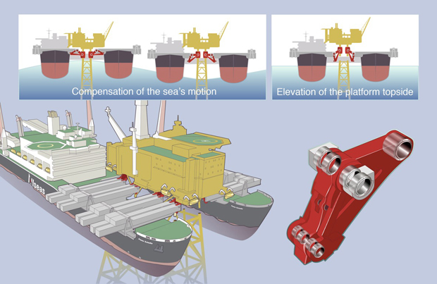

As soon as the ship moves around a drilling platform that is firmly anchored to the seabed, the enormous loads caused by the waves and acting on the ship have to be compensated. The TLS levers allow for these wave motions. The hydraulic cylinders of the TLS in turn ensure that the platform topsides can be elevated and lifted off safely.

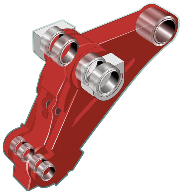

Schaeffler supplies maintenance-free large spherical plain bearings with an ELGOGLIDE sliding layer to Allseas for the TLS levers.

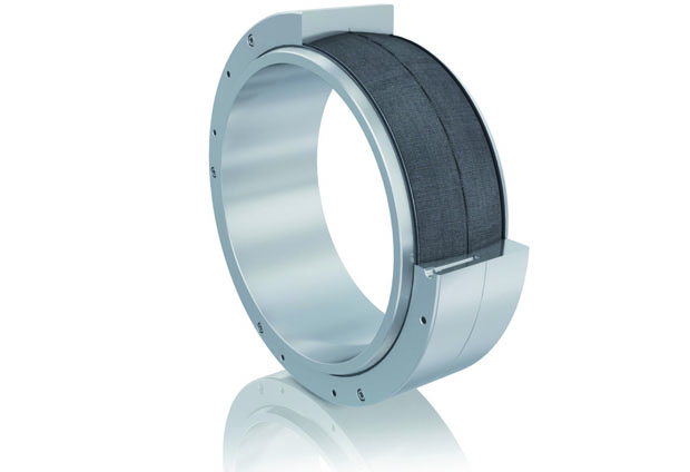

ELGES large spherical plain bearings in X-life quality feature an outer ring equipped with an ELGOGLIDE fabric sliding layer and allow low-friction sliding motion with a very high load carrying capacity.

Schaeffler supplies maintenance-free large spherical plain bearings with an ELGOGLIDE sliding layer to Allseas for the TLS levers and to Bosch Rexroth for the TLS hydraulic cylinders.
As soon as the ship moves around a drilling platform that is firmly anchored to the seabed, the enormous loads caused by the waves and acting on the ship have to be compensated. The TLS levers allow for these wave motions. The hydraulic cylinders of the TLS in turn ensure that the platform topsides can be elevated and lifted off safely without any damage occurring. The bearings must have a very high load carrying capacity, both for load compensation and to allow for the motion of the hydraulic cylinders.
Our spherical plain bearings in X-life quality are equipped with extremely robust and maintenance-free ELGOGLIDE material. Offshore use of the bearings requires very high corrosion resistance, high moisture resistance for the sliding material, and freedom from maintenance over an operating life of at least 25 years. The bearings have been certified by Lloyd’s Register to meet the safety requirements of the marine industry.
The screw connection of the axially split outer ring was optimized as part of the introduction of X-life for ELGES large spherical plain bearings. The fabric additionally undergoes special treatment before the hardening process in order to improve its adhesive properties and optimize moisture resistance. Overall, X-life optimization has resulted in 15% higher load ratings and a 15% increase in rating and operating life. This also means additional benefits for the customer, including downsizing opportunities and a higher power density, longer service intervals, and an increase in overall cost-effectiveness (TCO).
