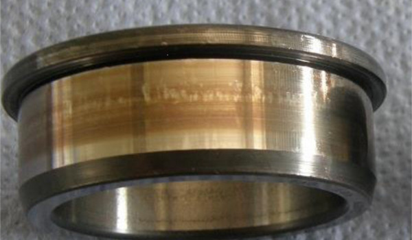

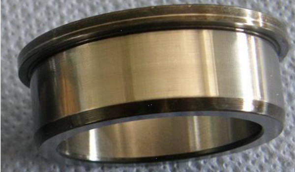

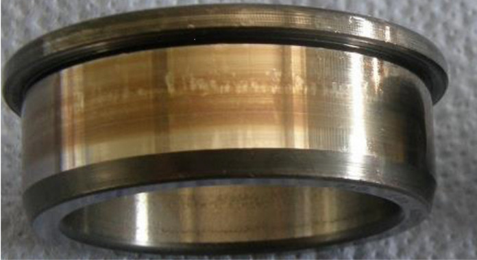

As part of a theoretical consideration of the bearings in a power take-off (PTO) gearbox, the lubrication was investigated more closely. It was found that, under the given operating conditions, the lubricant’s viscosity was much too low to form a sufficiently effective lubricant film. Increased wear and a reduced service life would have been the logical consequence. NKE therefore recommended the use of a more viscous, i.e. thicker lubricating oil.
To be on the safe side, a practical test was performed, in which two identical gearboxes were filled with the lubricating oils to be compared and run for a period of 500 hours. In the subsequent survey, discolorations and initial signs of wear were clearly visible on the functional surfaces of the bearing run with the thinner oil (Figure 2). The bearings operated with the thicker oil did not show any signs of wear (Figure 3).
The customer’s fear that the thicker oil would result in higher power dissipation proved unfounded. On the contrary: the gearbox with the more viscous oil exhibited lower losses and therefore also a reduced operating temperature. This can be attributed to the better separation of the metallic surfaces in operation, which more than compensates the slightly higher fluid friction.

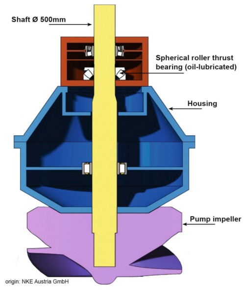

During test operation of a large cooling water pump – a concrete volute pump, i.e. a centrifugal pump with vertical shaft in a cast concrete housing (Figure 4) – the axial bearing at the drive end repeatedly exceeded its permissible operating temperature, resulting in an automatic shutdown. On closer inspection, the use of an unsuitable lubricant for this application was identified as the culprit. The oil in question was a pure hydraulic oil, which did not in any way meet the bearing’s requirements in terms of either composition, i.e. additives, or viscosity.

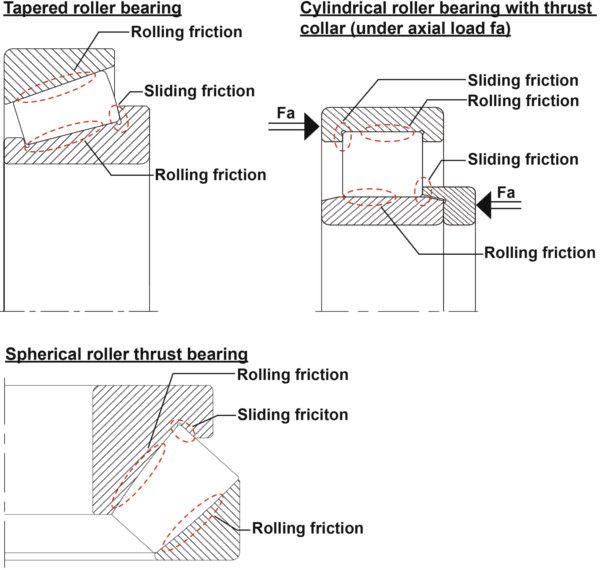

The high measured operating temperature was the direct result of the metallic contact and resulting friction especially between the side faces of the rolling elements and the guide lips of the shaft locating washers (see spherical roller thrust bearing in Figure 1). This resulted in irreversible damage to the bearings’ functional areas within just a short time, in effect preventing reliable long-term operation. The bearings had to be replaced at considerable expense on site.
By changing to a suitably viscous oil selected for the application parameters and the use with spherical roller thrust bearings, a reliable separation of the contact surfaces and a low operating temperature were achieved. The plant has now been in fault-free operation since 2009.
