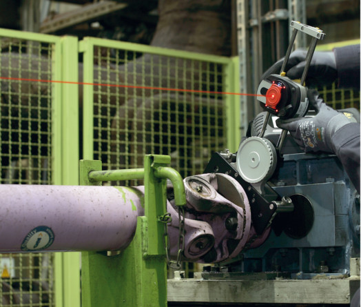

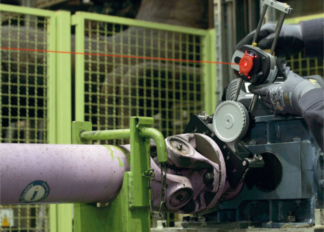

Using the specially designed bracket with a rotating arm, cardan shaft alignment is now a matter of minutes. Attach the pre-mounted brackets on the shafts using the supplied chains, enter dimensions, rotate shafts to the next measurement position and take the readings.
Since the sensor is mounted on a rotating arm, it can be turned back as the shafts are rotated. The sensor is then moved along the posts to intersect the laser beam. This procedure is repeated for several shaft positions to capture the necessary readings. The alignment condition is accurately measured only after as little as a 60° shaft rotation and the angular cardan misalignment can be corrected by moving the machine according to the displayed feet correction values. Depending on the application at hand, the whole alignment job can be completed within less than half an hour.
