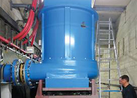

Figure 1: The vertical motor is flange-mounted directly above the centrifugal pump. Alignment corrections are made by shifting the electrical motor on the flange
A total of 16 centrifugal pumps feed the water into the pipe network. Haltern Waterworks have an annual capacity of 129 million cubic meters.
The 16 pumps consist of 13 verticalpumps with an electrical power rating of 1,100 KW at 1,486 rpm and 3 horizontal pumps with an electrical power rating of 1,600 KW at 742 rpm.
Figure 2: The structure of the vertical pump is graphically depicted in the report with details that allow it to be readily identified

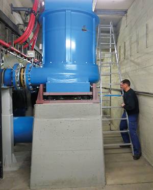

The machines are overhauled every 5 years and are then remounted and realigned. Good alignment ensures smooth operation of the pumps throughout their service life. On account of the long service interval, it is important to optimize all of the parameters to keep the machines running properly until the next scheduled overhaul.
Figure 3: The entire pump aggregate is mounted on vibration dampers for smoother running
Incorrect alignment leads to a markedly higher level of vibration, which can cause premature damage to the bearings and floating ring seals.
Figure 4: Vertical pump after remounting but before alignment

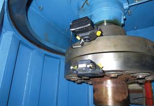

Immediately after the overhaul and reinstallation of the motor, technicians check the alignment and, if necessary, correct it before the machinery goes back into operation.The vertical pump is measured using OPTALIGN smart RS
First, the procedure requires the machine dimensions and flange sizes such as the flange diameter, bolt circle diameter and number of bolts.The readings are taken at predefined locations.Ideally, up to 8 measurements can be taken at an interval of 45°. These measurements are then used to compute the results.
Figure 5: Installation of the laser and receiver with the mounted Bluetooth module

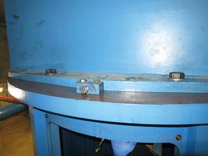

Figure 6: Adjusting bolts on all four sides of the motor are designed for adjusting the
After the motor has been aligned, final verification measurements are taken and stored electronically for quality assurance.
Figure 7: After correction and final measurement, the motor exhibits perfect alignment of the shafts.
