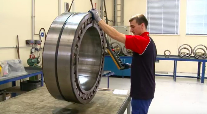

Remanufacturing: the key stages
- Inspection and analysis – this will provide information regarding modes of failure, so steps can be taken to ensure that the remanufactured bearing does not suffer in the same way. It will also determine the extent of remanufacturing required, including:
- partial remanufacture – this is mostly a polishing exercise, reusing existing components;
- extensive remanufacture – this may involve the wholesale replacement of components and the re-grinding of raceways.
All remanufactured bearings are subsequently quality inspected and marked for traceability before being packed and returned to the customer. Note that unused bearings which may have degraded due to lengthy or incorrect storage can also be fully restored to ‘as-new’ condition.

SKF offers a remanufacturing service that covers all major brands of bearings used throughout the heavy manufacturing industries. In addition to reducing energy use, this service ensures that responsible cleaning methods are used and waste materials appropriately handled, helping to protect the environment.
Watch this short video of SKF’s bearing remanufacturing services in action.
