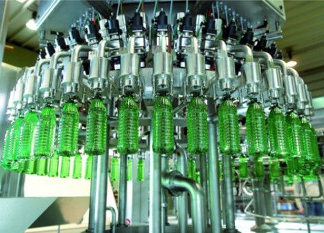

In a recent cam control solution for a bottle capping machine company, Schaeffler replaced its original solution – a standard stud type track roller immersed in an oil bath – with a roller stud, Cronitect outer ring, corrosion-resistant steel balls and an HRS seal. This improved solution requires no lubricating oil, has extremely high resistance to corrosion and aggressive media, while presenting no risk of contamination of foodstuffs. This has resulted in improved hygiene, reduced maintenance costs and higher machine availability.
