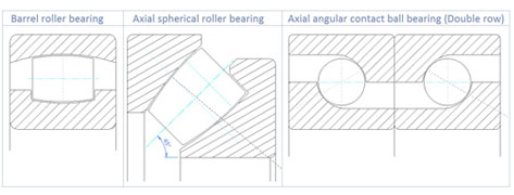

- Additional bearings types like axial spherical roller bearings, barrel roller bearings and double row axial angular contact bearing are now also supported. In total, 22 bearing types are available now.

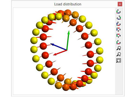

- New graphic for load distribution 3D, including contact ellipse or line load for rolling bearings.

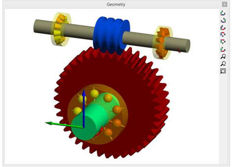

- Worm and worm gear as force elements, and worm gear connections for shaft systems.

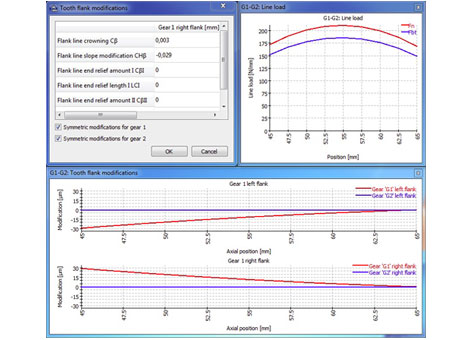

- Tooth flank modification for optimum gear contact can be considered independently for each flank. The modifications are taken into account in the calculation of line loads.
