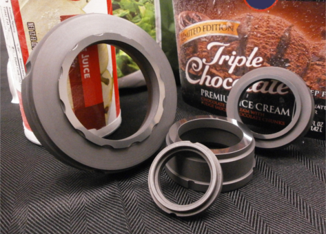

Metcar Grade M-444 offers self-polishing characteristics and dimensional stability
Metallized Carbon Corporation, a global leader in the manufacture of oil-free, self-lubricating, carbon-graphite materials for severe service lubrication applications, announces the availability of mechanical seal primary rings for sealing refrigerants and other low viscosity liquids.
Low viscosity liquids are difficult for mechanical seals because the hydrodynamic film that they create between the two rubbing seal faces is extremely thin. In order for this extremely thin hydrodynamic film to lubricate the two sealing faces, the seal faces must stay highly polished and they must run in very close proximity to each other. It is the self-polishing characteristic of the M-444, antimony impregnated, carbon-graphite material and the high dimensional stability of both solid silicon carbide and antimony impregnated carbon-graphite that enables these two materials to run in the required close proximity. Ordinary mechanical seals with resin impregnated, carbon-graphite primary rings do not have the self-polishing characteristic or the dimensional stability that is required for sealing these low viscosity liquids.
