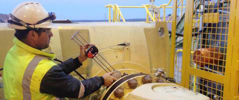

Fig. 1: The alignment of a machine with the cardan shaft in place.

Setting up is virtually as simple as with any regular rotatable, coupled alignment using PRÜFTECHNIK measurement technology: Mount the sensor and laser using the supplied brackets, enter dimensions and take measurements.
The onscreen tutorial and instructions are very easy to understand, so you always know what to do next.

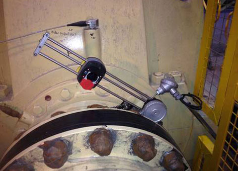

Fig. 2: The entire measurement task was completed without removal of the 7500 kg cardan shaft.
The laser was set up at the stationary end using a non-rotating arm bracket. At the moveable machine end of the shaft, a rotating arm bracket was used to mount the sensor. As the coupled shaft was rotated to each new measurement position, the rotating arm bracket was turned back at the base and the sensor moved along the posts to intersect the laser beam and take the necessary readings. The procedure was repeated at several shaft angular positions to capture the alignment condition, after which the required machine adjustments were made and checked.
