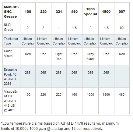

Properties MobilSHCgreaseApplications
Application Considerations: While Mobilith SHC Series greases are compatible with most mineral oil based products, admixture may detract from their performance. Consequently it is recommended that before changing a system to one of the Mobilith SHC Series, it should be thoroughly cleaned out to achieve the maximum performance benefits. While the Mobilith SHC Series greases share many performance benefits, their applications are best described in terms of each product grade:
• Mobilith SHC™ 100 is an antiwear and extreme pressure grease primarily recommended for higher speed applications such as electric motors, where reduced friction, low wear and long service life are required. It is an NLGI 2 Grade / ISO VG 100 grease with a synthetic base fluid. Its operating temperature range is -40º C* to 150º C.
• Mobilith SHC™ 220 is a multi-purpose, NLGI 2 extreme pressure grease recommended for heavy-duty automotive and industrial applications. It uses an ISO VG 220 synthetic base fluid. Mobilith SHC 220 has a recommended operating temperature range of -40º C* to 150º C.
• Mobilith SHC™ 221 is a multi-purpose, extreme pressure grease recommended for heavy-duty automotive and industrial applications, particularly where centralized grease systems are utilized. It uses an ISO VG 220 synthetic base fluid. Mobilith SHC 221 has a recommended operating temperature range of -40º C to 150º C.
• Mobilith SHC™ 460 is an NLGI 1.5 Grade grease with ISO VG 460 synthetic base fluid and is an extreme pressure grease recommended for tough industrial and marine applications. It provides outstanding bearing protection under heavy loads at low-to-moderate speeds and in applications where water resistance is a critical factor. Mobilith SHC 460 has demonstrated outstanding performance in steel mills, paper mills and marine applications. The recommended operating temperature range is -30º C* to 150ºC.
• Mobilith SHC™ 1000 Special is an NLGI 2 Grade grease with ISO VG 1000 synthetic base fluid and strongly fortified with solid lubricants including 11% graphite and 1% molybdenum disulphide for maximum protection of plain or rolling element bearings operating under boundary lubrication regimes. This product is designed to extend bearing life under conditions of extremely slow speeds, sliding contacts, and high temperatures. Mobilith SHC 1000 Special has a recommended operating temperature of -30°C* to 150 °C with appropriate relubrication intervals.
• Mobilith SHC™ 1500 is an NLGI 1.5 Grade / ISO VG 1500 grease with a synthetic base fluid. It is intended for use in plain and rolling element bearings operating at extremely slow speeds, under heavy loads and high temperatures. Mobilith SHC 1500 has a recommended operating temperature range of -30 ºC* to 150 ºC with appropriate relubrication intervals. Continuous lubrication with Mobilith SHC 1500 has been very effective in prolonging bearing life in a severe roll press application. Mobilith SHC 1500 has also provided excellent performance in rotary kiln roller bearings and in slag transfer rail car bearings.
• Mobilith SHC™ 007 is an NLGI 00 Grade / ISO VG 460 grease with a synthetic base fluid; it has a recommended operating temperature range of -50º C to 150 º C with appropriate relubrication intervals. Its primary uses are in grease filled industrial gear cases subject to high temperatures, where conventional semi fluid greases will not provide acceptable lubricant life and in non-driven heavy-duty truck trailer wheel hubs.
