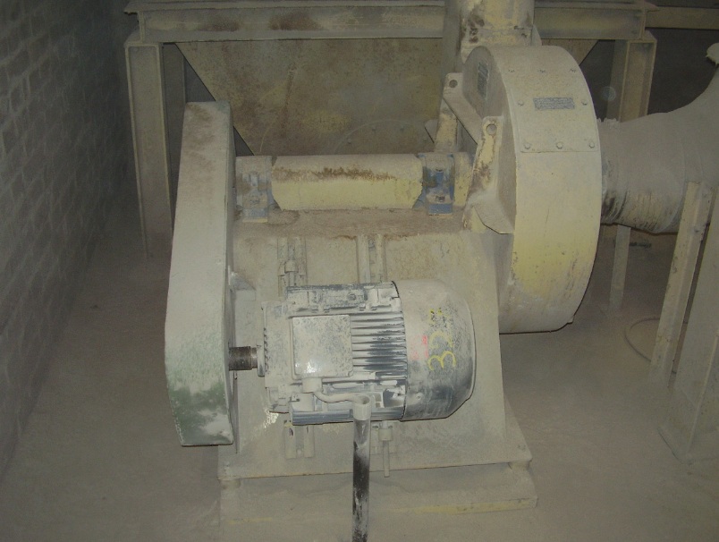

While large roller bearings are increasingly being equipped with automatic continuous lubrication systems, this is not cost-effective in fans such as the one shown in Figure 1.
Figure 1: Fan

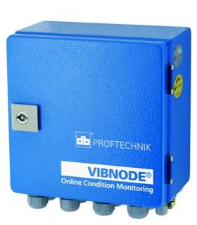

These units are lubricated by hand at specific intervals. But how long should these intervals be? Online Condition Monitoring Systems from PRÜFTECHNIK can provide the answer. When a roller bearing runs ‘dry’, a rough running sound arises that can easily be detected in the high frequency acceleration spectra, for example. At that point, it is high time to relubricate the bearing to lower vibration strain.
Figure 2: VIBNODE®

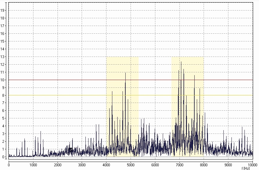

With advanced frequency-selective CMS like VIBNODE®, the broadband disturbance frequencies shown in Figure 3 can be selected as “characteristic lubrication values” and the associated amplitudes can be monitored as trend values.
Figure 3: Broadband disturbance frequency

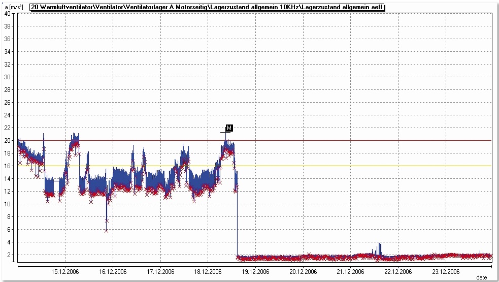

Figure 4 shows that lubrication intervals can be determined easily: After lubrication, the amplitude of the acceleration decreased markedly. Of course, to use this analytical method, you must first identify the frequency band on which the lubrication condition has an impact.
Figure 4: After Greasing
