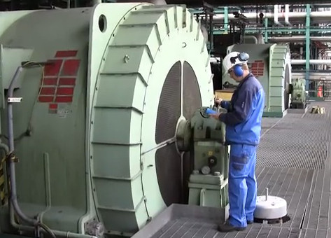

In recent years, improvements to instrumentation and software have challenged the concept of ultrasound applications as ONLY a simple inspection tool for leak detection. Many successful reliability teams have adopted ultrasound as an important tool for condition monitoring and predictive maintenance. Monitoring rolling contact bearings and acoustic assisted lubrication are performed daily using ultrasound. This has freed up valuable time for vibration analysts to focus on assessing critical assets first identified by ultrasound as being in a problematic state.
Plain bearings are widely used in turbo machinery and many other types of machines in the plant. Different to rolling contact bearings that enter a starved lubrication condition slowly and, therefore, are easier to trend, plain bearing lubrication requires a steady fluid film to work. Any situation that alters this oil flow leads to almost instantaneous contact-to-contact metal. Therefore, the window to failure for plain bearings is much smaller than it is for rolling contact bearings.

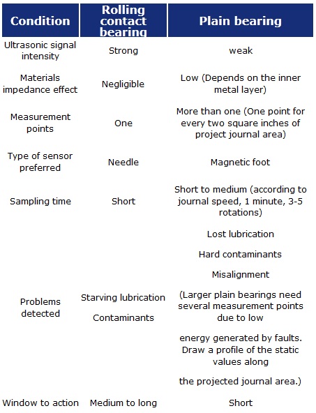

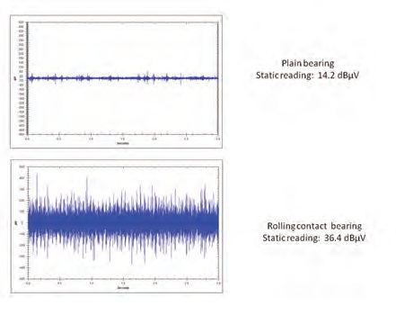

The data gleaned from monitoring plain bearings with ultrasound has some differences compared to rolling contact bearings. These differences are shown in Table 1.
Table1

A steady supply of lubricant keeps friction levels low. Soft contaminants are embedded in the soft metal liner, but hard contaminants scratch the journal surfaces and are revealed by random, high static peaks (RMS peaks) and increasing crest factor values.
The time waveform shows random peaks if the contaminants are floating. If the hard contaminants remain in the same position, the time trace will show sinusoidal peaks.

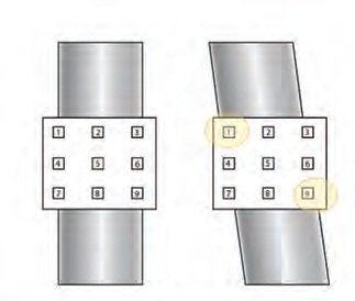

In mid- and large-size plain bearings, when comparing static ultrasound readings across several points, it is possible to uncover a misalignment situation. To illustrate this, Figure 5 shows an analysis of a hypothetical bearing that has nine measurement points over the journal’s projected area.
Points 1, 4 and 7 are located axially on the left side of the bearing, at the 9 o’clock position. Points 2, 5 and 8 are at the 12 o’clock position, while points 3, 6 and 9 are at the 3 o’clock position. Under normal operation, the maximum load (friction) should be at the 7 o’clock position (points 1, 4 and 7) and lower friction at the 12 o’clock position (points 2, 5 and 8). If the journal is aligned, these values should remain stable over time.
Figure 5For points 1, 4 and 7, the readings should be similar (highest in the bearing) and points 3, 6 and 9 also should have similar readings between them, but be a little higher than points 2, 5 and 8.
If points 1 and 9 increase and 7 and 3 decrease, or 7 and 3 increase and 1 and 9 decrease, it is a clear indication of an uneven journal rotation. By capturing dynamic signals with sample time sets that are long enough to reflect three to five shaft rotations, you will see a clear variation in signal along the time axis.

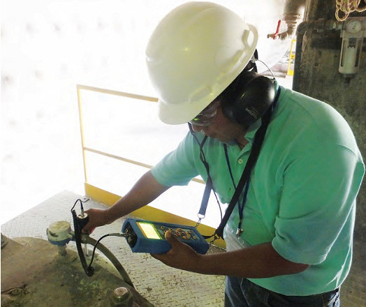

Testing plain bearings has proven challenging using traditional condition monitoring techniques. Oil analysis remains an important technology here. Advancements in ultrasound technology made by manufacturers are providing additional tools for assessing conditions in plain bearings. Follow the techniques here and use both static and dynamic data to observe changes. Always remember that the window to failure is a little bit smaller with plain bearings than it is with roller bearings and plan your uptime with the precision of ultrasound.
