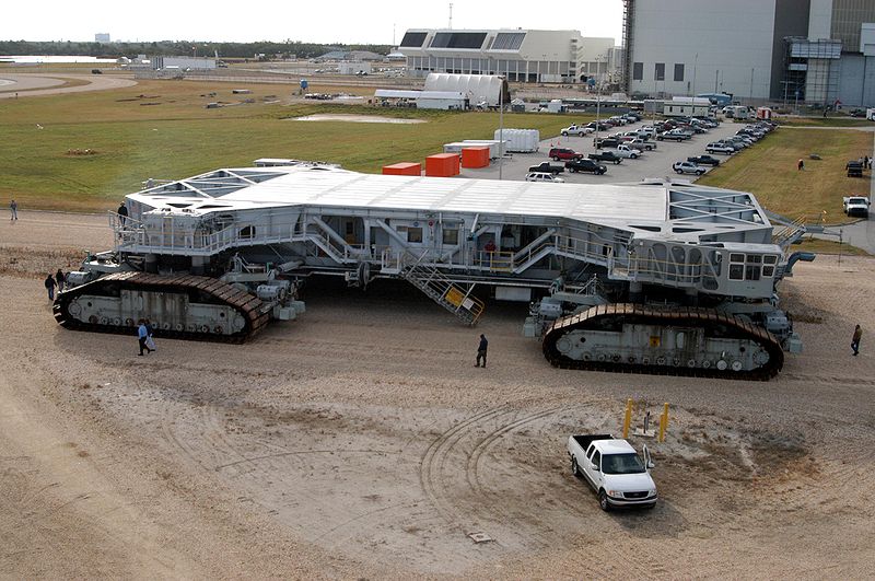

NASA has only 2 tracked vehicles in use for the transportation of carrier rockets like “Saturn” and the “Space Shuttle” on the launch pad at Kennedy Space Center. These are one of the world’s most existing engineering structures moving on tracks which are more than 45 years old. Despite the fact that the carriers were built in the 60s, they still have significant remaining life, and can still operate for decades after the upgrade which is planned by NASA.
NASACrawler-Transporter2A crawler-transporter carrying Discovery travels the ramp to Launch Pad 39B.

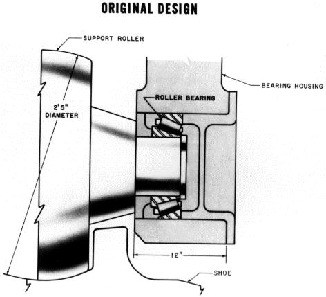

Initially, the nodes were supported by tapered roller bearings made from bronze alloy steel. Back in 1965, the tapered roller bearings could not stand the load of the platform during a test trip to the launching pad. The bearings could prevent deterioration of lubrication and heat dissipation, but failed to prevent the sudden destruction caused by the heavy loads.
Original designIllustration: NASA
The original design of the bearing assembly on basis of tapered roller bearings have failed the test trials

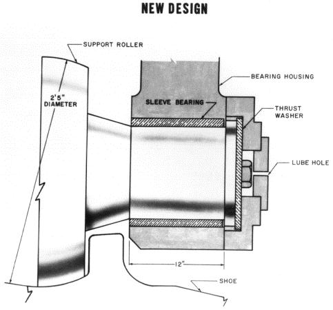

New designRevised bearing assembly on basis of the plain bearing
Difficulties with reduced friction and uniform distribution of the load on the body forced the developer of the roller conveyor back in 1965 to apply to the plain wheel bearings instead of tapered roller bearings
