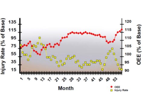

If safety is number one in your organization then repeatable, effective work procedures should be as well. Figure #1 shows the correlation between injury rate and OEE.
OEE-Safetywb
Figure 1: Injury Rates vs. OEE
Ron Moore’s book – Making Common Sense Common Practice

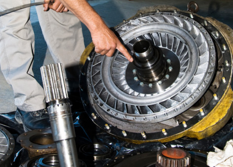

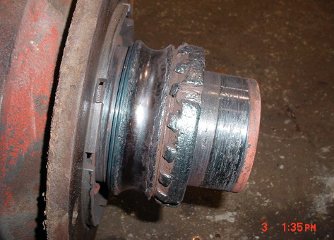

We may not know why the bearing in Figure 2 failed. It is easy to surmise that the correct lubricant, quantity, and re-lubrication interval were likely not clearly specified in the maintenance instructions related to the equipment.
211344-32wb
Figure 2. Bearing Failure Example

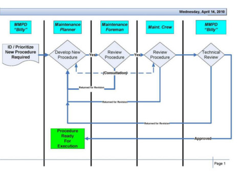

    2. Develop a process map for procedure development and approval along with defining roles and responsibilities. See Figure 3 and 4
WorkFlow-2wb
Figure 3 – Example: Procedure Process Map
