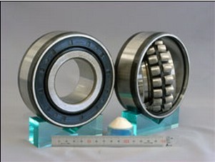

NSK Ltd. (NSK; Headquarters: Tokyo, Japan; President and CEO: Norio Otsuka) announced that it has developed a long-life sealed spherical roller bearing with improved abrasion toughness for application in heavy industries such as mining, iron and steel manufacturing and non-ferrous metals manufacturing. The improved life of this product provides customers with more stable operations and lower maintenance costs.

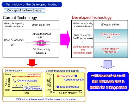

New Grease for Improved Abrasion Resistance
Spherical roller bearings do not technically roll, but rather slide. That is, the rolling element rotates while sliding on the raceway between the inner and outer ring in what is referred to as a “differential sliding” However, since these bearings are used in harsh conditions, this kind of differential sliding can easily result in a insufficient oil film, which in turn causes abrasion and eventual damage to the bearing.
In response to this situation, NSK has successfully developed a new grease with redesigned properties that sustain the oil film between the roller and the inner and outer rings even under harsh conditions. This results in about 10 times the level of abrasion resistance on the bearing raceway surface compared to the current product, which makes for longer bearing life.
NSK has a lineup covering sizes (external diameter) of 90 mm to 280 mm for application to all types of heavy industry equipment in industries such as mining, iron and steel manufacturing and non-ferrous metal manufacturing.
