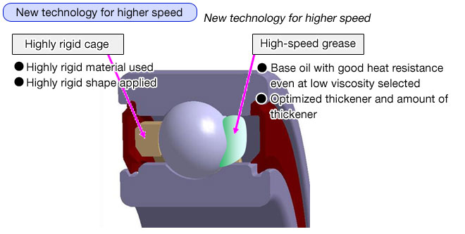

This product makes use of the proprietary NSK technologies outlined below to achieve a world-class, one million dmN.
1.The use of a highly rigid and lightweight cage with an improved shape made from a new resin material optimizes ball movement and enables high-speed rotation.
2.Optimization of the grease composition achieves improved bearing longevity under high-speed rotation.
•Suppression of heat generated during high-speed rotation by adoption of a low-viscosity base oil with good heat resistance.
•Furthermore, low tourque (low heat generation) has been enabled by selecting a thickener with outstanding fluidity
