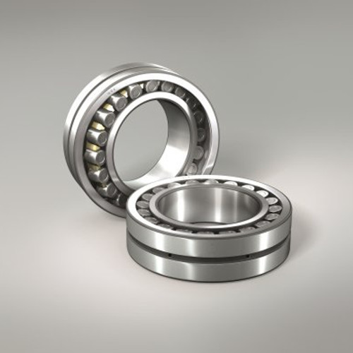

NSKHPS high performance spherical roller bearings featuring a high load factor have been developed specifically for applications of this type, and are manufactured and heat treated in accordance with NSK’s internal Wind Standard U 303.
