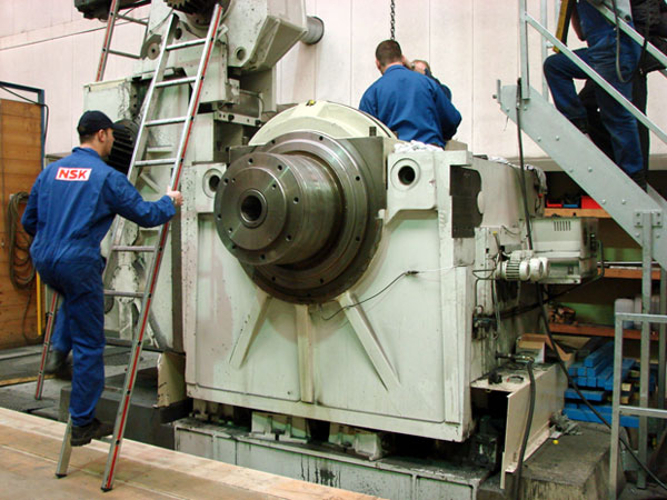

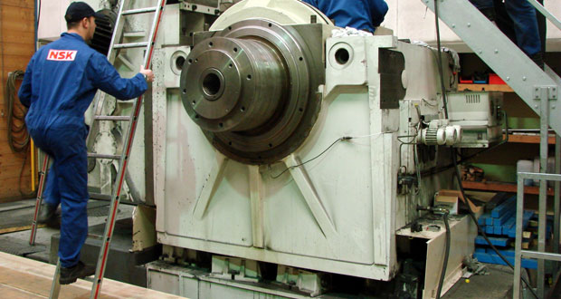

The sheaves are machined on a large surface wheel lathe that was rebuilt from an original longitudinal lathe produced many years ago by Zerbt. Although the machine, which has a face plate weighing 30 tonnes, gives good service, Doppelmayr faced a challenge when wear and tear dictated that the main spindle’s roller bearings required replacement.
Doppelmayr/Garaventa is the world market leader for cable cars

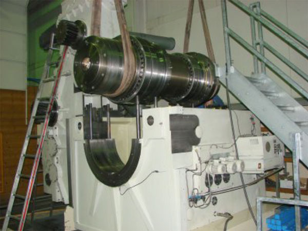

The principal problem in replacing the bearings related to the machine´s age and the fact that the original manufacturer had changed ownership. This meant there was no documentation relating to the main spindle assembly. For this reason, Doppelmayr turned to NSK, which was able to support the company in a reverse engineering project that would help identify the bearing locations and assembly parameters, including the bearing clearance and spacer ring width. NSK also helped develop strategies for replacing the bearings.
Experts from NSK supporting Doppelmayer’s maintenance personnel with the replacement of the main spindle bearing.

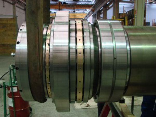

By characterising the installed bearings through reverse engineering, NSK was able to replace them in the central bearing positions with high precision double row cylindrical roller bearings in the correct sizes. The replacement took place during a planned maintenance period so that production schedules were unaffected. For the axial bearings, spacer rings were measured after setting the clearance and new ones manufactured in the required width.
Handling heavy loads with precision

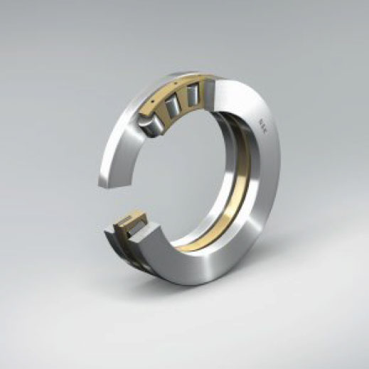

Cylindrical roller bearings used as high precision bearings for the spindle.
Post-installation, NSK technicians checked the clearance to make sure it was correct. This was facilitated by conducting a dynamic lift test, allowing the loading conditions to be simulated with the bearings installed. The process confirmed that the previously measured value of 0.005 mm had been successfully maintained.
The bearings in installed state
With the project complete and the surface wheel lathe ready to recommence operations, Doppelmayer’s maintenance team was given instructions by NSK to monitor the temperature of the bearings during the initial start-up phase. No irregularities were observed and the lathe is now back in full sheave production.
