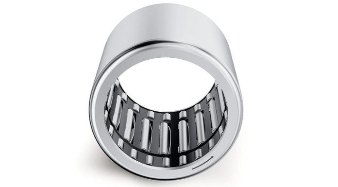

Drawn cup roller clutches are high precision machine elements consisting of thin-walled, drawn outer rings (drawn cups) with a series of ramps on the inside diameter, plastic cages, springs and needle rollers. They can be used in a wide range of applications as backstops or overrunning clutches. Drawn cup roller clutches have extremely compact radial dimensions and carry out indexing from the locking direction in the freewheel direction. Roller clutches with bearing supports can also support radial forces.
Due to their low mass and the resulting low moment of inertia of the clamping elements, drawn cup roller clutches from Schaeffler are characterised by their high indexing frequencies. They also have a low overrunning frictional torque. As the needle rollers are individually spring retained, the shaft, needle roller and clamping surface remain in contact with each other at all times, which enables a high indexing accuracy to be achieved.

The HF, HFL and FRAX series of drawn cup roller clutches are particularly popular in bicycle applications. HF one-way clutches have an extremely compact design but have no bearing supports and so can only transmit torques. HFL series one-way clutches can also support radial forces due to the integral plain or rolling bearings. Both one-way clutch series are suitable for aluminium housings. Roller clutches with a knurled outside surface have the suffix ‘R’ and are suitable for use with plastic housings.
