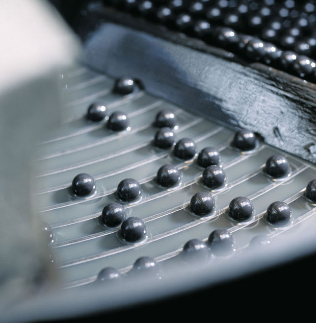

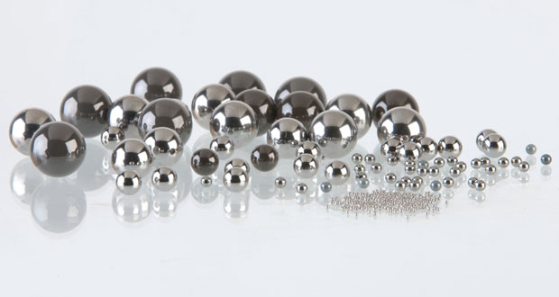

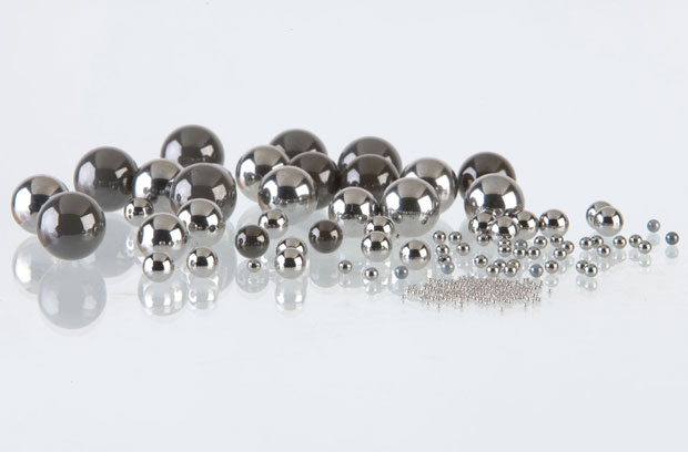

Ceramic hybrid bearings
For high-speed applications, replacing the steel balls with ceramic (silicon nitride) balls can radically improve bearing performance in several ways. First, because ceramic balls are much lighter than steel balls, reducing centrifugal forces and improving dynamic conditions whilst their surface finish is almost perfectly smooth, they exhibit vibration levels two to seven times lower than conventional steel ball bearings. At higher speeds, internal loading in the bearing is also reduced.
Secondly, ceramic hybrid bearings also run at significantly lower operating temperatures, which in conjunction with the lower mass allows running speeds to increase by as much as 40-50%. Lower operating temperatures and reduced heat build up inside the bearing helps extend lubricant life, sometimes up to five times longer than conventional steel ball bearings.
Examples of applications for ceramic hybrid bearings include high-speed vacuum pumps, medical/surgical hand tools and aerospace fans and generators.

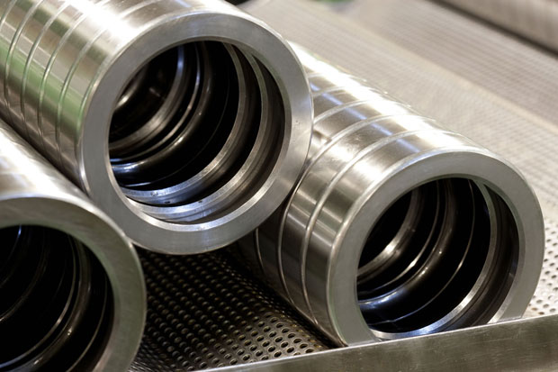

Materials
In materials technology, the most appropriate bearing materials can be selected to maximise bearing performance. Special ring materials are used successfully in aerospace and non-aerospace applications, combining superior corrosion and wear resistance with the ability to withstand higher dynamic loads than conventional bearing steels. When used in conjunction with ceramic balls, significant gains in bearing life and performance can be achieved.
Ring materials can be optimised for specific applications. The four predominant ring materials used by Barden are AISI 440C (corrosion-resistant steel), SAE 52100, AISI M50 and Cronidur 30®. For high temperature applications (up to 345°C) AISI M50 tool steel or a special tempered version of Cronidur 30® are suitable and are widely used in high temperature aerospace accessory applications such as bleed valve systems on aircraft.
Cronidur 30® is a martensitic through-hardened, high nitrogen, corrosion-resistant steel that can also be induction case hardened. This material enhances corrosion-resistance and improves the fatigue life and wear resistance.
