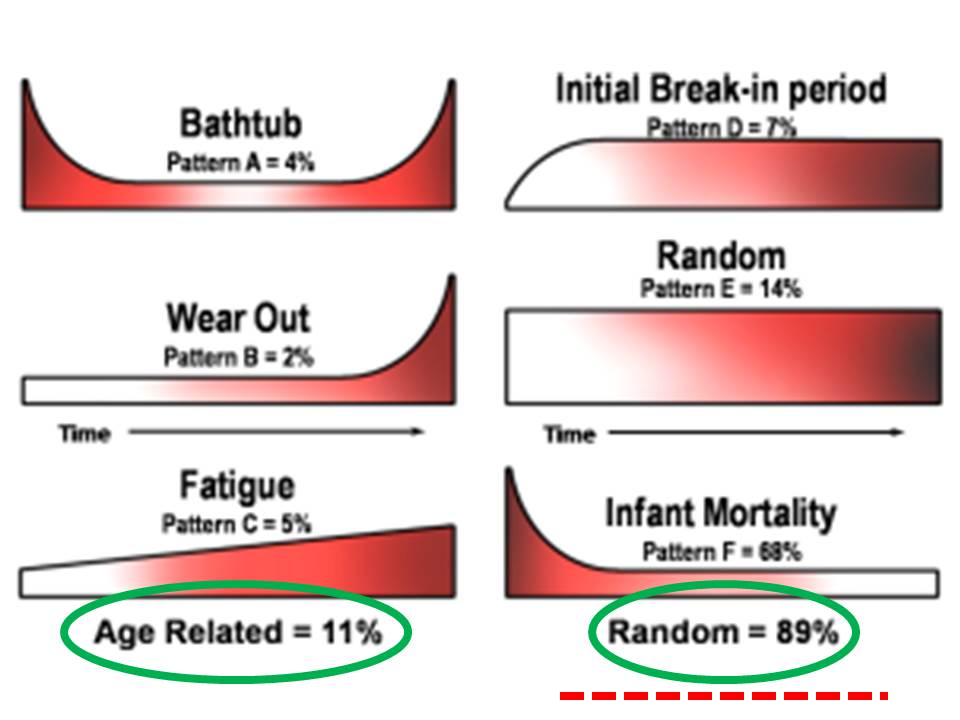

Lost in all of this is the concept of ensuring and sustaining reliability as both corrective and preventive maintenance is performed. Ideas about how things fail that we used to rely upon as a basis for preventive maintenance have been shown in the four failure profile studies over the past 40 years to apply to only a minor percentage of failures. In gambling terms, this means that odds are very long against a “win.” From this it can be shown that time directed maintenance, in general, also should apply to only a minor portion of the failure modes which an organization must correct or mitigate. This is because we seldom know the profile for a failure and  assume  that  most  components exhibit a “wear-out” characteristic, but assign a frequency for maintenance anyway, as if they did.
Failure-Patterns
Nowlan and Heap Study – Most Failures are Random
Further it can be shown that intrusive, time directed maintenance can be detrimental to reliability because humans are involved and they produce “infant failures.” Non- intrusive maintenance and monitoring tasks should be sought, instead. Indeed, because of the distribution of the failure profiles described in this paper, the only logical approach for the mitigating failures in the majority of equipment is through the use of non-intrusive tasks supported by the use of procedures to assure consistent results.
