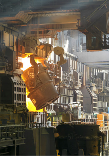

The entire process chain, from blast furnace to finishing, is covered by SSAB Europe´s four production sites in Scandinavia. As part of a planned maintenance project, three converter gearboxes recently had to be overhauled and equipped with new bearings at the company´s Raahe plant near Oulu, Finland. Gearbox manufacturer David Brown Santasalo was duly commissioned to perform the work, the first stage of which involved removing the gearboxes from the converter and dismantling them at its Jyväskylä factory, some 300km south.

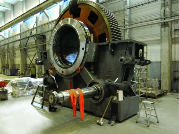

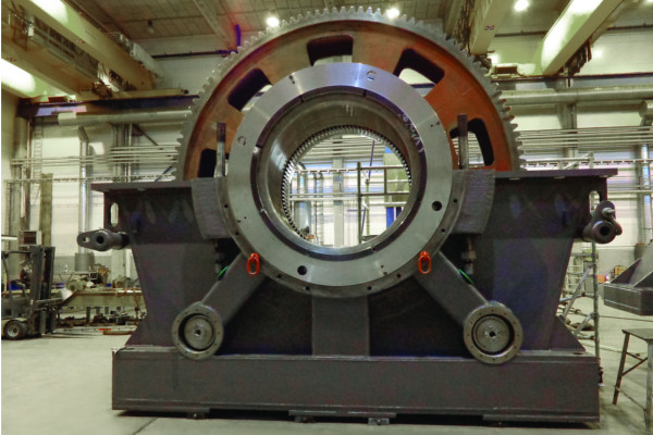

After a full and detailed assessment of the application and its requirements, NSK set about developing bearings with a higher static load rating and user-specific dimensions to replace the existing tapered roller bearings. In total, six 1800mm internal diameter bearings were manufactured, weighing 2250kg each. Prior to shipping, NSK specialists devised a strategy for simultaneously installing the inner and outer ring on the gearbox sprocket wheel with the assistance of a specially designed tool.
The bearings were subsequently shipped to Jyväskylä where NSK supervised their installation using the special tool; this made it possible to adjust the bearing gap exactly.
NSK devised a formula that could define the width of the shims needed for axial bearing clearance after mounting. This had to take into account dimensions such as fixed side bearing assembled width, free side bearing assembled width, fixed side bearing inner ring width, housing diameter, and the distance of the inner ring shoulder to shaft. Following an NSK inspection sheet, each dimension was measured by David Brown Santasalo using a co-ordinate measuring machine.
After checking the measurement values and calculation, NSK was able to recommend an axial bearing clearance of 1800 to 2100µm. Both the mounting of the bearing and adjustment of axial clearance using the shim took place in the vertical position. However, the gap was adjusted again in the horizontal position due to low housing stiffness (split housing) and heavy overall weight. The top part of the gearbox housing alone weighs 11.7 tonnes, while the sprocket wheel fitted with both bearing rings weighs 11.9 tonnes. Once installed, the result (within the required tolerances) was checked by NSK technicians. NSK also asked SSAB to visit David Brown Santasalo´s site to see the mounting procedure take place.
