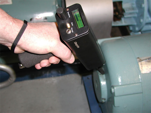

Ultrasonic Bearing Inspection Method
There are three methods for ultrasonic bearing monitoring:
- Comparative
- Historical
- Analytical

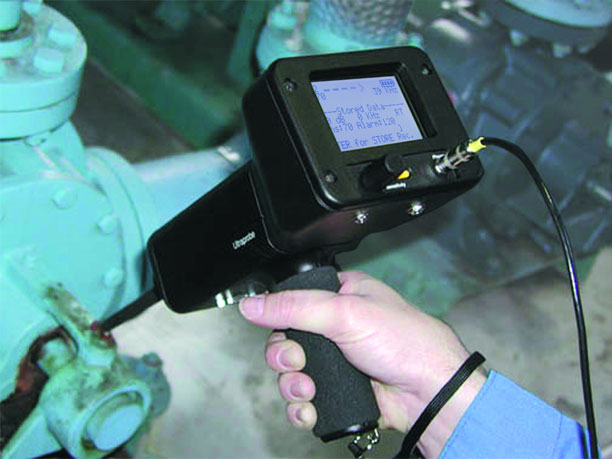

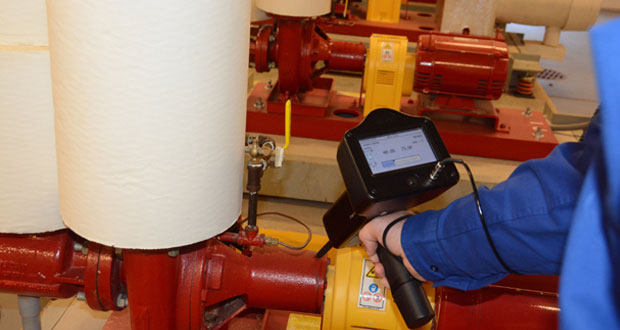

In order to note possible deviations that might indicate a possible failure condition or to establish a baseline for future surveys, compare similar bearings to each other for differences in amplitude and sound quality. To do this, make a permanent reference point on a bearing housing or use the grease fitting, tune to 30 kHz and adjust the received sound level so that the intensity or decibel level can be observed on the display panel.
Then compare this base reading to other similar bearings, while listening for any sound quality anomalies. Once a series of bearings have been tested, and a base line set, data is recorded and then compared to future readings for historical trending and analysis. High and low alarm levels can be set to note any bearings in need of corrective action.
An 8 dB gain over a baseline with no change in sound quality will indicate a need to lubricate due to depleted lubricant. Levels such as 16 dB or higher can signify a potential failed condition.

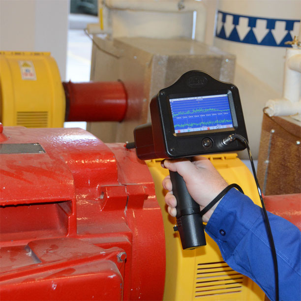

The analytical approach can be integrated into the comparative or historical process. Sound anomalies can be recorded and analysed through spectral analysis software. Some of the advanced instruments have on-board spectral analysis providing the ability to diagnosis issues while performing inspections out in the plant.

- Ultraprobe 15.000 (with on-board sound recording and spectral analysis, IR thermometer, camera and touch screen controls)

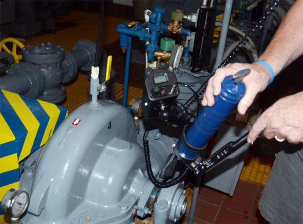

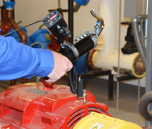

- Ultraprobe 201 Grease Caddy (analog instrument especially designed for assisted lubrication)
- Ultraprobe 401 Digital Grease Caddy Pro (digital instrument especially designed for assisted lubrication, allows for data collection and trending)
