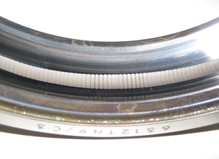

Static charges may have a variety of causes. In film stretchers, for example, plastic material is conveyed on steel rollers, leading to electrostatic charging. In tumble drier drums, the plastic content of the laundry, such as nylon, may be the cause. Rolling bearings operating under high loads have a particularly high risk of damage, since there is frequently partial direct contact between the rolling elements and the raceways, leading to sudden discharge, not unlike an electric arc. As the metal-to-metal contact is restricted to a very small area, even currents well below 1 ampere can cause the contact points to weld or fuse together. Typical discharge damage is in the form of plates, craters or grooves on the bearing.

Craters are the result when surface melting takes place on raceways due to electric potential. Molten metal particles may also be carried off and deposited on the raceway, where they are rolled down. Grooves form when current flows while the rolling elements and the raceways are under load. This causes the rolling elements to vibrate and, over time, typical grooves form on the inner and/or outer ring. Repairing such damage takes a lot of time and money – in extreme cases, the bearing as a whole has to be replaced. The severity of the damage depends on a number of factors, such as current intensity, time of exposure, bearing load, speed and lubricant used.

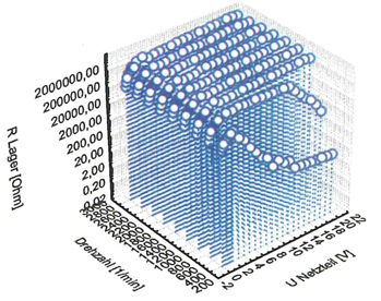

conductive greases02Figure 1: Insulating model grease with a base oil viscosity of 70 mm2/sec at 40 degrees C. With a resistance of 2 million Ohm over the whole speed and voltage range applied, this combination of grease and bearing shows an insulating behavior.

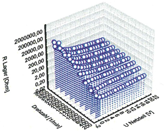

conductive greases03Figure 2: Conductive model grease with a base oil viscosity of 70 mm2/sec at 40 degrees C. The electrical resistance is considerably lower and depends on the bearing speed and applied voltage, making a difference of up to four powers of 10.

The higher conductivity of greases can be ascertained under dynamic conditions, such as in a rotating bearing. This is done on a purpose-built test rig, where a DC voltage of up to 20 V is fed into running, insulated ball bearings. By determining the voltage drop across the bearings and determining the current intensity, electrical resistance can be calculated. The bearings can be run at varying speeds, which allows conclusions on how the resistance depends on a bearing’s speed. (see Fig. 1 & 2)
