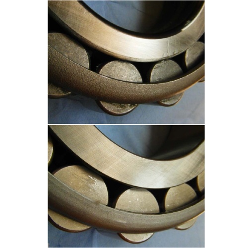

When a test run of the drive without the centrifuge resulted in a temperature increase at the shaft of up to 80 °C after just an hour and a half and the shaft seized due to thermal expansion, the focus shifted to the quality of the upper tapered roller bearings, type HR 30322J.

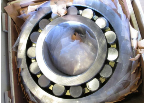

After NSK received detailed images of the bearings, it was clear: all of the bearings were counterfeit and did not originate from NSK production. The counterfeiters had taken great pains with the appearance of the bearings; even the company logotype looked deceptively authentic. The best way to tell the difference between the original and the counterfeit was the processing quality of individual bearing components.
No more increases in temperature with original bearings of higher quality
New bearings were ordered from an NSK Authorised Distributor and then installed. Test runs demonstrated that the temperature of the bearings and the shaft remained below ambient temperature, even after nine hours in continuous operation, because the original bearings feature significantly higher quality in both material and processing. Now the drive cooling was able to function properly and there were no more knocking sounds. Moreover, the entire drive ran much more quietly than before.
