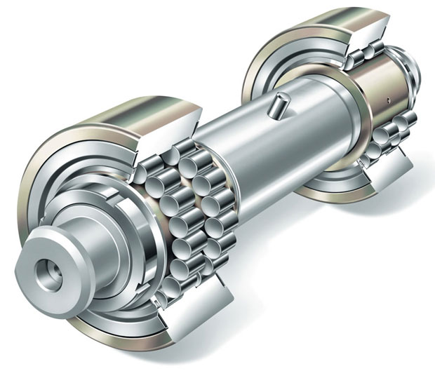

The yoke type track roller, which was custom designed by Schaeffler in the early 1990s specifically for use on the Pendolino train, is part of a yoke type track roller unit that is used on the coach body tilting system. In conjunction with the rails, the yoke type track roller units act as a roller-supported cradle system, which allows the coach body to tilt into bends in the track in such a way that the direction of the coach body axis matches the resulting acceleration.
Operationally critical
The yoke type track roller unit complete or “Tilt Roller Bearing” comprises two bearing assemblies, a bespoke split core resilient bushes and a two-part tilt roller housing. The built-up assembly is bolted to the bogie frame – two per bogie – these provide the base dynamic stability for the profiled and hardened “tilting shapes” to travel over when the train is operating in tilting mode. Without the robust and reliable tilt roller yoke bearings, the key tilting capability of the class 390 Pendolino would not be able to operate. The yoke bearings are very reliable units and have performed consistently between overhauls.

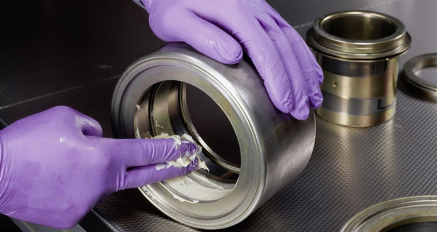

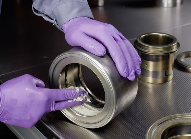

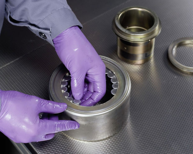

The double row yoke type track roller comprises of a crowned outer ring, a full complement cylindrical roller set, inner ring, thrust washer, Lamellar ring, Nilos ring and retaining ring. The unit is sealed, greased and protected against corrosion.
At Schweinfurt, the refurbishment process involves dismantling the track rollers and 100% visually inspecting all individual components for any signs of wear or damage, which can include fatigue, cracks, corrosion and indentations caused by overrolled particles. All the parts are then cleaned to remove grease, adhesive and dirt. Any defective contact rings are replaced with new ones. Outer and inner bore diameters are checked according to dimensional requirements. The units are then re-assembled, sealed, greased, packaged and returned to Alstom’s warehouse in Preston.
