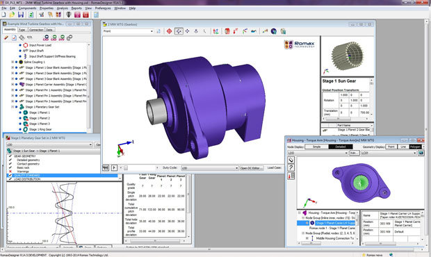

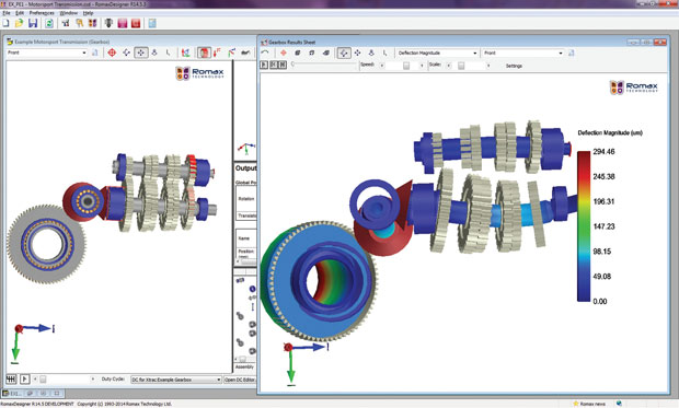

Using accurate design simulation software capable of running parametric studies across a range of parameters simultaneously, such as bearing clearances and manufacturing tolerances, is essential. It is possible to pinpoint where problems could arise and mitigate the issue by making the design less sensitive and therefore avoiding potential expensive problems.
The use of design simulation technology at the initial stages of concept development gives you the opportunity to conduct parametric studies to optimize the full system under differing operating conditions that can be encountered throughout a Rail Network. Data outputs can help decipher the root cause of failure before a failure has even occurred. It’s often surprising to operators that a disruption causing countless delays can be something as small as minor misalignment issues or simply bearings settings that are slightly out of place. National railway operators risk exposing themselves to serious backlash if things aren’t running smoothly. They need to take a proactive approach by identifying and eliminating integration issues at the start.
Some railway operators, such as Irish Rail, a national provider of rail and related services in Ireland, are not only taking this proactive approach to fixing problems, but also identifying the root cause to avoid similar problems in the future. When the company started seeing an increasing number of bearing failures in a particular fleet of rolling stock, it wanted to track down the cause, so it approached Romax Technology to help.
Romax was able to provide a review of all design and service data, and perform a physical analysis of the axle box bearings, simulation and modelling using its in-house developed driveline analysis software RomaxDESIGNER. The result means Irish Rail is now in a much better position to limit the amount of failures, project operations and consequently reduce risk.

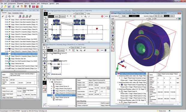

The right design simulation and analysis software offering should include exploration of the complete driveline, including gearboxes, couplings, bearings, electrical motor and supporting structures such as bogie frame, axle and wheel. This wide scope of analysis, using software designed for speed and accuracy, allows for the number of design cycles to be significantly reduced.
Component life and the overall efficiency of an entire fleet can be calculated, allowing for effective on-going system development. Stakes are high, and the consequences involved with ignoring the durability and longevity of a railway system can be serious, especially with passenger numbers continually on the increase. Something as straightforward as using a design simulation software program to replicate failures and test the durability of a system can save you a world of issues in the long term.
