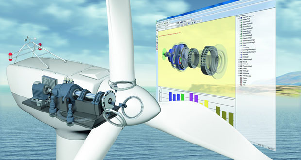

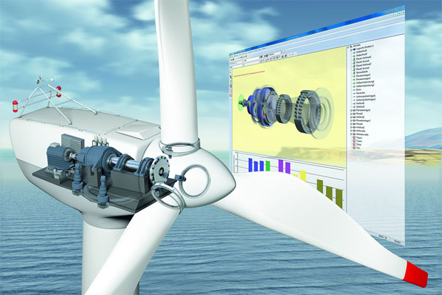

Optimum design with state-of-the-art calculation and simulation programs
Along with many years of experience and extensive system expertise, the specialists at Schaeffler ensure the optimum design of wind power bearings with especially state-of-the-art calculation and simulation programs. Schaeffler takes the entire system into account, from individual rolling bearings and their components to the adjacent structures and the complete drive train, which is depicted and optimized with multi-body simulation programs developed in-house.

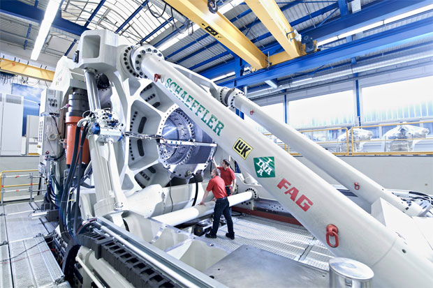

Realistic tests on Schaeffler ASTRAIOS
The calculations are enhanced and validated on powerful test rigs. Bearings up to 3.5 meters in outside diameter can be tested on one of the most state-of-the-art and biggest large-size bearing test rigs in the world. ASTRAIOS simulates the real loads and torques which occur in a wind turbine. Thus, Schaeffler contributes decisively to a faster and more reliable design of wind turbines and increases their cost-effectiveness and safety.
